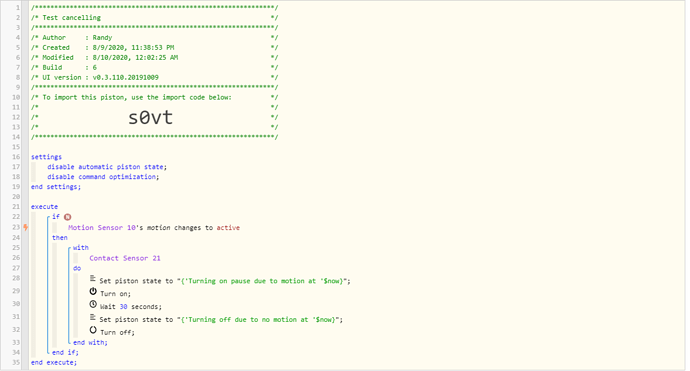

have a motion sensor that turns on a virtual switch - I want it to wait X amount of time, and if it hasn’t detected more motion (i.e. motion=inactive), then turn off that virtual switch
  1. Motion Sensor detects motion & turns on Contact Sensor
  2. wait X amount of time (30 seconds in my sample, but 20 mins in real life)
    3a) if the motion sensor was not triggered again, turn off the Contact Sensor
    3b) if the motion sensor was triggered again in the X window, restart the timer
  2. Motion Sensor stops detecting motion inside the X amount of time (so <30 secs in my example)
  3. Piston runs through because it is subscribed to the Motion Sensor, but cancels the pending timer task
  4. because the timer task is cancelled, the Contact Sensor never gets turned off
I have tried changing the “Task Execution Policy” (and currently have it set to ‘never cancel’, though that does not seem to be affecting this issue), and I think this is probably something small, but I can’t seem to figure it out!
Thank you in advance for any help - love this forum!
**4) Post a Green Snapshot of the piston![image|45x37]![image|690x361]

try 2-3 minutes for testing,.
Some motion sensors stay active 30 sec or more.
Thanks, Ike - I have tried that, but lowered for this testing. This particular sensor makes a loud click, so I know when it turns on/off… Plus, I can see in the logs when that happens - the switch is turning off before the 30 second timeout, which is causing the schedules to cancel.
UPDATE: I just figured out I was putting the “Never Cancel” at the wrong level - I set the “With” on line 25 to never cancel, and that seems to have fixed it. (As long as I don’t keep the motion switch activated for longer than the timeout period, that is - otherwise when it hits the timeout (30s in my example), it sends the command to turn the Contact Sensor back off anyway…)
Anyway - thank you for looking at it - I appreciate it!
Hopefully you mean the ‘Task Cancellation Policy’. If you are going to use that, I recommend you set it on the ‘with’ action, or the ‘wait’ task itself. Although it can be set on conditionals it isn’t clear what it actually does when it is in that position.
Ah you fixed it while I was typing.
