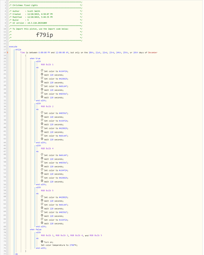

Not sure how long you are waiting. This piston will only cycle one bulb changing it every 2 minutes and then move to the next bulb. Each time it changes, it will stop and set a timer for the next color. Don’t think that was your intention. The log you posted, did that have logging set to full?
Not at the time, I have it set for full logging for tonight. Are you saying that in order to have four separate RGBW bulbs repeat a pattern of colours, I will need a while-loop piston for each bulb?
Not necessarily but you do need to change all four bulbs before going to the wait. Remember, this will execute top to bottom. What you have will change bulb 1 to 1st color, wait 2 minutes, change to second color, wait 2 minutes, after the fourth color, wait 2 minutes, change bulb 2 to 1st color, wait 2 minutes, etc. If you want all four to be different colors, you will need 4 with statements before each wait statement.
I have so many ideas for this one, but will not be able to focus on this until after the holidays… :slightly_frowning_face:

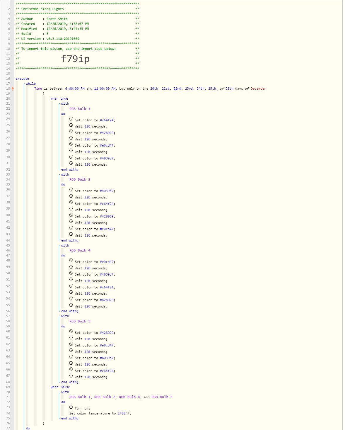

Hi, i’m still having trouble with the piston stopping at the first colour ser. I changed it so all four lights change at once, but it only does it for the first set and stops. rotate|290x500
12/22/2019, 6:14:31 PM +601ms
+1ms ╔Starting piston… (v0.3.10a.20190223)
+351ms ║╔Subscribing to devices…
+583ms ║║Subscribing to Flood 1…
+584ms ║║Subscribing to Flood 2…
+585ms ║║Subscribing to Flood 3…
+586ms ║║Subscribing to Flood 4…
+587ms ║╚Finished subscribing (241ms)
+629ms ║Comparison (time) 65672215 is_between (time) 61200000 … (time) 0 = true (11ms)
+631ms ║Time restriction check passed
+705ms ║Cancelling statement #2’s schedules…
+712ms ║Requesting time schedule wake up at Mon, Dec 23 2019 @ 12:00:00 AM EST
+1967ms ║Setting up scheduled job for Mon, Dec 23 2019 @ 12:00:00 AM EST (in 20726.434s)
+1977ms ╚Piston successfully started (1976ms)
12/22/2019, 6:14:29 PM +814ms
+106ms ╔Stopping piston…
+176ms ╚Piston successfully stopped (71ms)
(Issue solved, moved statements into do block)
Thanks everyone, got it working!
