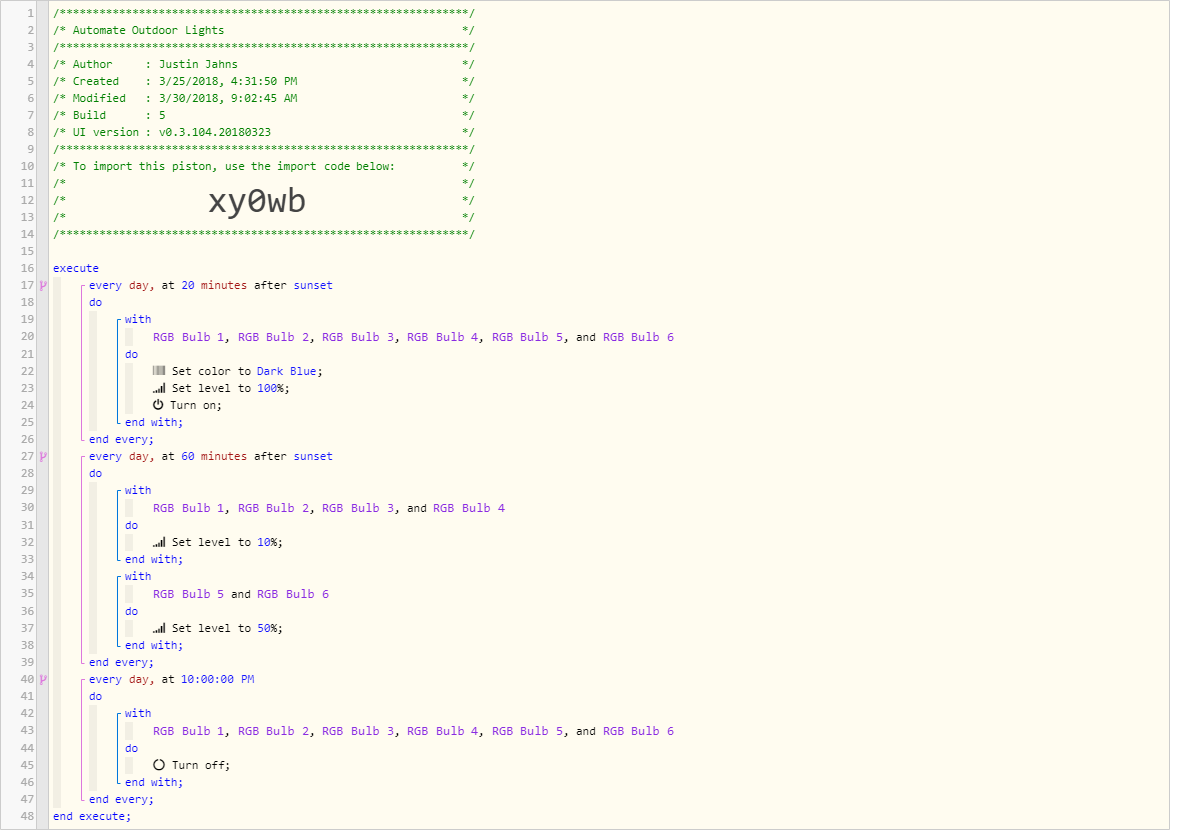

Just installed WebCore about a week ago and recreated all my Core Pistons into WebCore but having an issue with one of my more simple pistons…
The set device level action with several bulbs only performs the action on the first bulb in the list.
The set device level action to be performed on each bulb in the list.
The actions at 20 minutes after sunset works fine on all six bulbs. The set device level action at 60 minutes after sunset only completes successfully on the first bulb in each list. The turn off action at 10pm works as expected on all six bulbs.

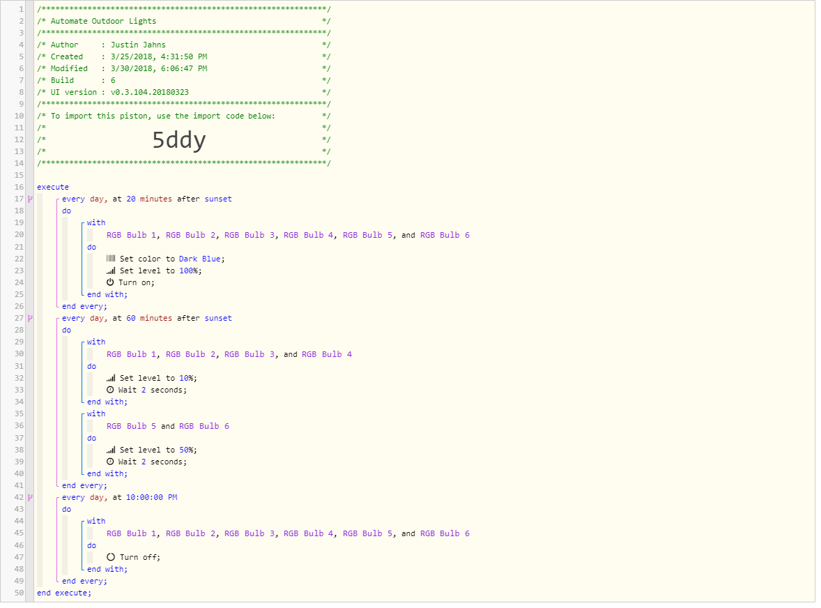

Try adding wait 10 seconds before the set level to 50%
I added a 2 second wait after the set level to 10% and another 2 second wait after the set level to 50%. All six bulbs successfully adjusted level. However, I was expecting to see each bulb change it’s level 2 seconds after one another, but it just adjusted the first four and 2 seconds later adjusted the other two. So I guess I only needed the extra 2 seconds between operations? Just trying to understand…
Thanks!
Justin

(The way you currently have it, any command on the same line all happen at the same time)
That makes perfect sense.
I guess what I’m confused on is why the wait in between these two sets of actions fixes my issue…
Thanks,
Justin
I am not for sure what is happening behind the scenes, but I have noticed in the past that when there are too many commands being sent simultaneously, some do not get thru to the devices reliably. I now have a habit of putting in tiny pauses splattered about in my pistons, (usually 1 second or less after complex commands) and my pistons have a much higher success rate.
