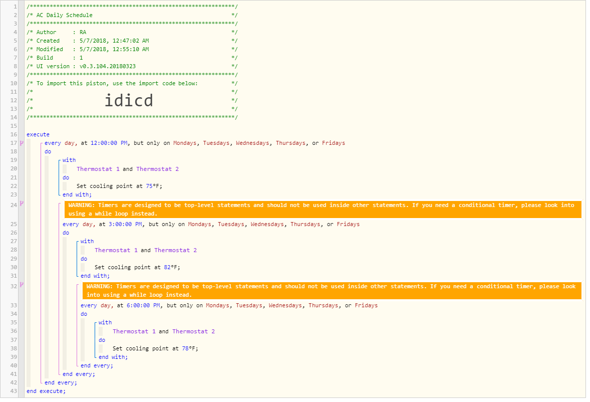

New to WebCore but need to understand how to set up multiple Timers for Thermostat. For example at 12:00pm adjust AC to 75. At 3:00pm adjust to 78. At 9:00pm adjust to 76.
Have Thermostat adjust everyday to schedule. Without setting up multiple ST routines

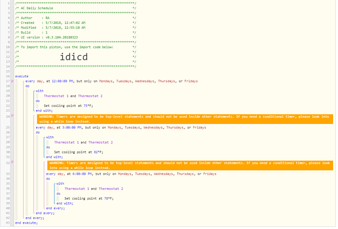

Get Warning message. Timers are designed to be top level statements and should not be used inside other statements…
(UPLOAD YOUR IMAGE HERE)
Your 2nd and 3rd statements are nested under the first one. You’ll need to have them at the same level as the first one.
Remove the 2nd and 3rd statements. Re-add them at the bottom but selecting the link that says “Add new statement” which is at the bottom above “End execute”.
It’s OK to have more than one statement in a piston.
There is no need to remove them and add them back. All anyone needs to do is drag them to their new location. :slight_smile:
