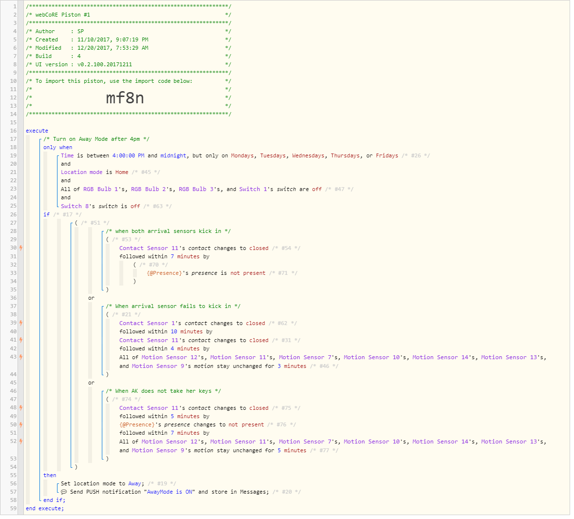

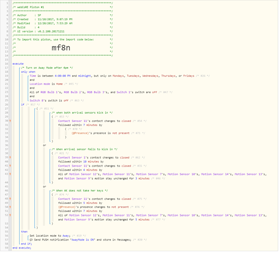

I have 3 conditions, if any of them are true then mode changes to away.
One of the condition is with arrival sensor which is the fastest. So it changes mode to away.
other is based on motion detection. So when their is no motion, mode changes to away.
But I am getting multiple notifications if more than 1 condition is true.
If one of the condition is true and mode is changed, then piston should stop checking other conditions.
