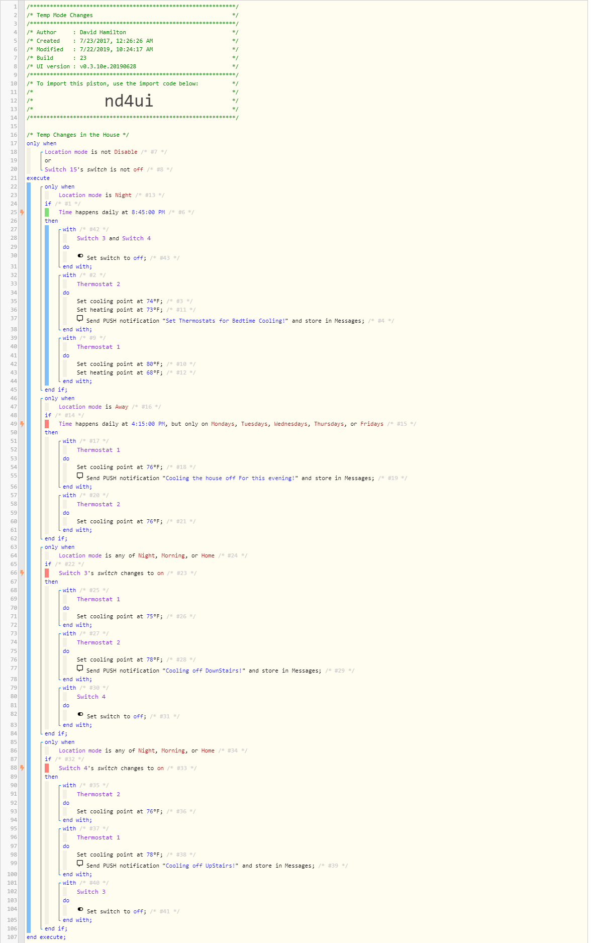

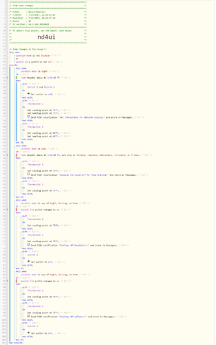

So I have a piston with two timed events in regards to my thermostat. Neither of the two timed events interfere with each other. It seems when the 4:15 timer runs and doesn’t execute due to a restriction it never gets scheduled again unless I re-save the piston.
I expect the time piston to be scheduled M-F @ 4:15 everyday even if it doenst fire from the day before.
It seems when the 4:15 timer runs and doesn’t execute due to a restriction it never gets scheduled again unless I re-save the piston. I just happen to be home today with temps already set. So the piston would not fire @ 4:15 because I was home. But @ 8:45 when that portion fired it should of scheduled a 4:14 for the next day and it set the 8:45 for the next day.

According to your log above, at 4:14:59 PM, it scheduled a wakeup for 8:45:00 PM, so that part looks ok. The error I see is after running at 8:44:59 PM on the 23rd, the schedule is set for 24 hours later. (skipping 4:15 the next day)
Normally, when there are two timers in the same piston, whenever the piston is saved or executed, it will schedule a wake up for the next time. I think your piston above skipped 4:15 due to your ONLY WHEN block. You could slightly reword it something like this:
Every day at 4:15PM  <-- Top level command
Do
    IF Location is Away
        Do stuff w/Thermostat
    END IF
END EVERY
With this method, you are more assertive in your times, and the location will not be checked until that timed event. This ensures that the next schedule should always be set correctly at the end of each execution.
That makes sense… I ll rewrite it and test. thanks for your input. Originally I only had one timer but as time goes on… You know! You add stuff!
