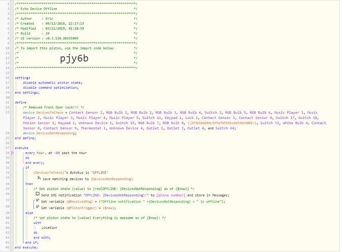

My Webcore is haunted - keeps repeating a piston over and over
I have a piston that checks for offline devices. It’s been going haywire for the past few minutes.
The piston is supposed to check offline status of devices every hour. (For some reason, it only checks at 9:00 AM and PM, but that’s not a biggie.) I finally had to pause the piston so Alexa would stop announcing it.
It has been repeating the offline status of devices about 10 times in the past few minutes. The door lock has been offline for a long time - not a big deal. The gate light has been giving me issues today (and my kitchen light switch - a GE Enbrighten switch - would no longer connect as of 7:30 AM…don’t know if that’s related or not. Amazon is sending a replacement tomorrow, so I’ll check it then.)

+2721ms ║║Condition #5 evaluated true (2398ms)
+2723ms ║║Condition group #1 evaluated true (state did not change) (2399ms)
+2726ms ║║Cancelling statement #2’s schedules…
+2751ms ║║Calculating (string) OFFLINE: + (string) Front Door Lock and Gate Light >> (string) OFFLINE: Front Door Lock and Gate Light
+2757ms ║║Calculating (string) OFFLINE: Front Door Lock and Gate Light + (string) ! >> (string) OFFLINE: Front Door Lock and Gate Light!
+2807ms ║║Executed virtual command sendSMSNotification (44ms)
+2810ms ║║Cancelling statement #8’s schedules…
+2838ms ║║Calculating (string) Offline notification + (string) Front Door Lock and Gate Light >> (string) Offline notification Front Door Lock and Gate Light
+2843ms ║║Calculating (string) Offline notification Front Door Lock and Gate Light + (string) is offline >> (string) Offline notification Front Door Lock and Gate Light is offline
+2847ms ║║Executed virtual command setVariable (2ms)
+2859ms ║║Executed virtual command setVariable (2ms)

+5017ms ╚Event processed successfully (5017ms)
03/11/2019, 01:12:34 +84ms
+0ms ╔Received event [Home].execute = recovery with a delay of 251ms
+206ms ║RunTime Analysis CS > 26ms > PS > 79ms > PE > 101ms > CE
+210ms ║Runtime (51723 bytes) successfully initialized in 79ms (v0.3.110.20191009) (209ms)
+211ms ║╔Execution stage started
+1684ms ║║Comparison (string) ONLINE is (string) OFFLINE = false (2ms)
+1688ms ║║Comparison (string) ONLINE is (string) OFFLINE = false (1ms)
+1691ms ║║Comparison (string) ONLINE is (string) OFFLINE = false (2ms)
+1695ms ║║Comparison (string) ONLINE is (string) OFFLINE = false (2ms)
+1699ms ║║Comparison (string) ONLINE is (string) OFFLINE = false (3ms)
+1702ms ║║Comparison (string) ACTIVE is (string) OFFLINE = false (2ms)
+1706ms ║║Comparison (string) ONLINE is (string) OFFLINE = false (2ms)
+1710ms ║║Comparison (string) ONLINE is (string) OFFLINE = false (2ms)
+1714ms ║║Comparison (string) ACTIVE is (string) OFFLINE = false (2ms)
+1717ms ║║Comparison (string) ACTIVE is (string) OFFLINE = false (2ms)
+1721ms ║║Comparison (string) ACTIVE is (string) OFFLINE = false (3ms)
+1725ms ║║Comparison (string) ACTIVE is (string) OFFLINE = false (2ms)
+1728ms ║║Comparison (string) ACTIVE is (string) OFFLINE = false (2ms)
+1732ms ║║Comparison (string) ACTIVE is (string) OFFLINE = false (2ms)
+1736ms ║║Comparison (string) ONLINE is (string) OFFLINE = false (2ms)
+1739ms ║║Comparison (string) OFFLINE is (string) OFFLINE = true (2ms)
+1743ms ║║Comparison (string) ONLINE is (string) OFFLINE = false (2ms)
+1746ms ║║Comparison (string) ONLINE is (string) OFFLINE = false (2ms)
+1750ms ║║Comparison (string) ONLINE is (string) OFFLINE = false (2ms)
+1754ms ║║Comparison (string) OFFLINE is (string) OFFLINE = true (2ms)
+1757ms ║║Comparison (string) ONLINE is (string) OFFLINE = false (2ms)
+1761ms ║║Comparison (string) ONLINE is (string) OFFLINE = false (2ms)
+1765ms ║║Comparison (string) ONLINE is (string) OFFLINE = false (2ms)
+1768ms ║║Comparison (string) ACTIVE is (string) OFFLINE = false (1ms)
+1771ms ║║Comparison (string) ONLINE is (string) OFFLINE = false (2ms)
+1775ms ║║Comparison (string) ONLINE is (string) OFFLINE = false (2ms)
+1779ms ║║Comparison (string) ACTIVE is (string) OFFLINE = false (2ms)
+1783ms ║║Comparison (string) ACTIVE is (string) OFFLINE = false (2ms)
+1786ms ║║Comparison (string) ONLINE is (string) OFFLINE = false (2ms)
+1790ms ║║Comparison (string) ONLINE is (string) OFFLINE = false (2ms)
+1794ms ║║Comparison (string) ONLINE is (string) OFFLINE = false (2ms)
+1797ms ║║Comparison (string) ONLINE is (string) OFFLINE = false (2ms)
+1801ms ║║Comparison (string) ONLINE is (string) OFFLINE = false (2ms)
+1805ms ║║Comparison (string) ACTIVE is (string) OFFLINE = false (2ms)
+1808ms ║║Comparison (string) ACTIVE is (string) OFFLINE = false (2ms)
+1812ms ║║Comparison (string) ACTIVE is (string) OFFLINE = false (2ms)
+1826ms ║║Condition #5 evaluated true (1605ms)
+1828ms ║║Condition group #1 evaluated true (state did not change) (1607ms)
+1832ms ║║Cancelling statement #2’s schedules…
+1842ms ║║Calculating (string) OFFLINE: + (string) Front Door Lock and Gate Light >> (string) OFFLINE: Front Door Lock and Gate Light
+1846ms ║║Calculating (string) OFFLINE: Front Door Lock and Gate Light + (string) ! >> (string) OFFLINE: Front Door Lock and Gate Light!

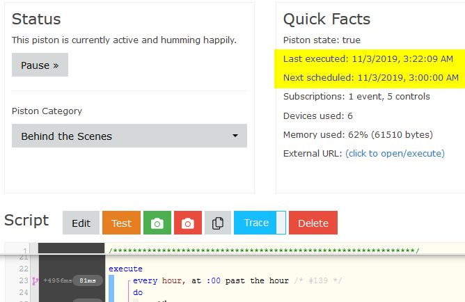

It’s likely the automated time change… (remember, we are essentially going back “in time”) Some pistons may be off an hour today… Some pistons may have to be paused, and then resumed to work right.
Notice the times on this one:
temp
Damn, you’re probably right. Totally forgot about that, lol
Noticed this today with one piston that I have running a periodic check and also setting a date/time variable on other requests. Off part is, everything straightened itself out just by opening the piston and clicking save. :slight_smile:
Every spring and fall I really feel bad for folks that run any system dealing with time. It is such a pain to deal with under the best circumstances and Daylight Savings Time is anything but!!! I will say this, previous DST adjustments have been extremely painful. This year was wonderful! Whatever (if anything) the webCoRE team did to deal with them so much better, it is very appreciated! Thank you!! :bowing_man: :+1:
