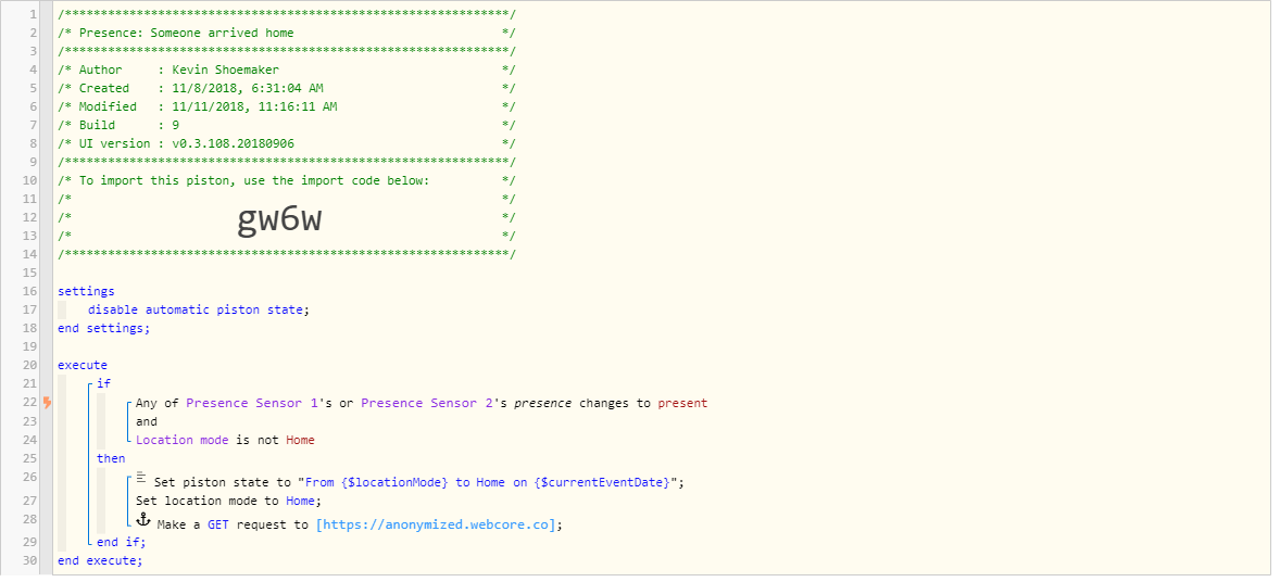

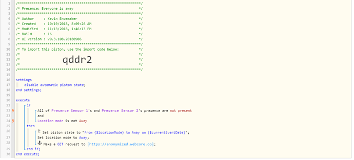

I have 2 very similar pistons to control location mode based on presence or 2 devices. 1 piston subscribes to only the presence indicators while other piston subscribes to presence AND location mode.
It seems the location mode is only referenced as a condition, not a trigger, so it shouldn’t be subscribed in either pistion.
It appears at times that the location mode subscribed piston encounters semaphore wait times. I’m trying to understand why.

The first has one trigger and one condition…
The second has only conditions, so they are treated as triggers.

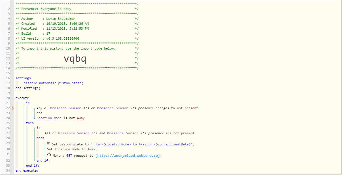

Thanks for the prompt reply. That makes perfect sense.
I had trouble writing the “both devices not presence” condition as a trigger since they won’t happen at the same time. Any suggestions on a better way to write that one?
There are many ways to accomplish this. One idea:
IF PresenceA changes to present  (trigger)
    IF PresenceB is present  (condition)
    Then Do Stuff
    END IF
END IF
This one fires off when B is already home, and A arrives
IF PresenceB changes to present  (trigger)
    IF PresenceA is present  (condition)
    Then Do Stuff
    END IF
END IF
This one runs when A is already home, and B arrives

I use my previous post since I want different things happening depending on who is arriving home.
