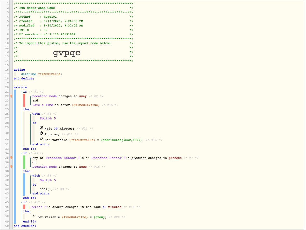

I wrote the piston to start the Neato D3 when no one is home and 30 minutes has elapsed, and also to dock if not finished and someone is back. The Neato starts cleaning but will not dock.
I want the Neato to dock when some is back. I also want to change the way it behaves if someone comes back and cut the cleaning short. I’m a time value but I would like to base it on the map itself and if possible to pick up where it left of…if on the same day.
(So far it works good based on what i put into the piston i.e.: it cleans the house when we are gone but it is not docking. I don’t feel my piston is efficient.

Have you tried to make a barebones piston that the whole purpose is just to test docking?
Yes and will not dock. The command dock is sent as seen in the log, the Neato just keeps going.
That is something we’re not able to assist with unfortunately. You might have to check with the device handler developer for assistance first. One thing to check is if you can make the bot dock manually by triggering it on the device tile in the ST app.
Thanks. I tried my luck on the smartthings community forum but didn’t get help.
That is a great suggestion to try via the smart app… unfortunately the new ST app doesn’t show the tiles… and my ST Classic hangs and won’t open the smart app.
