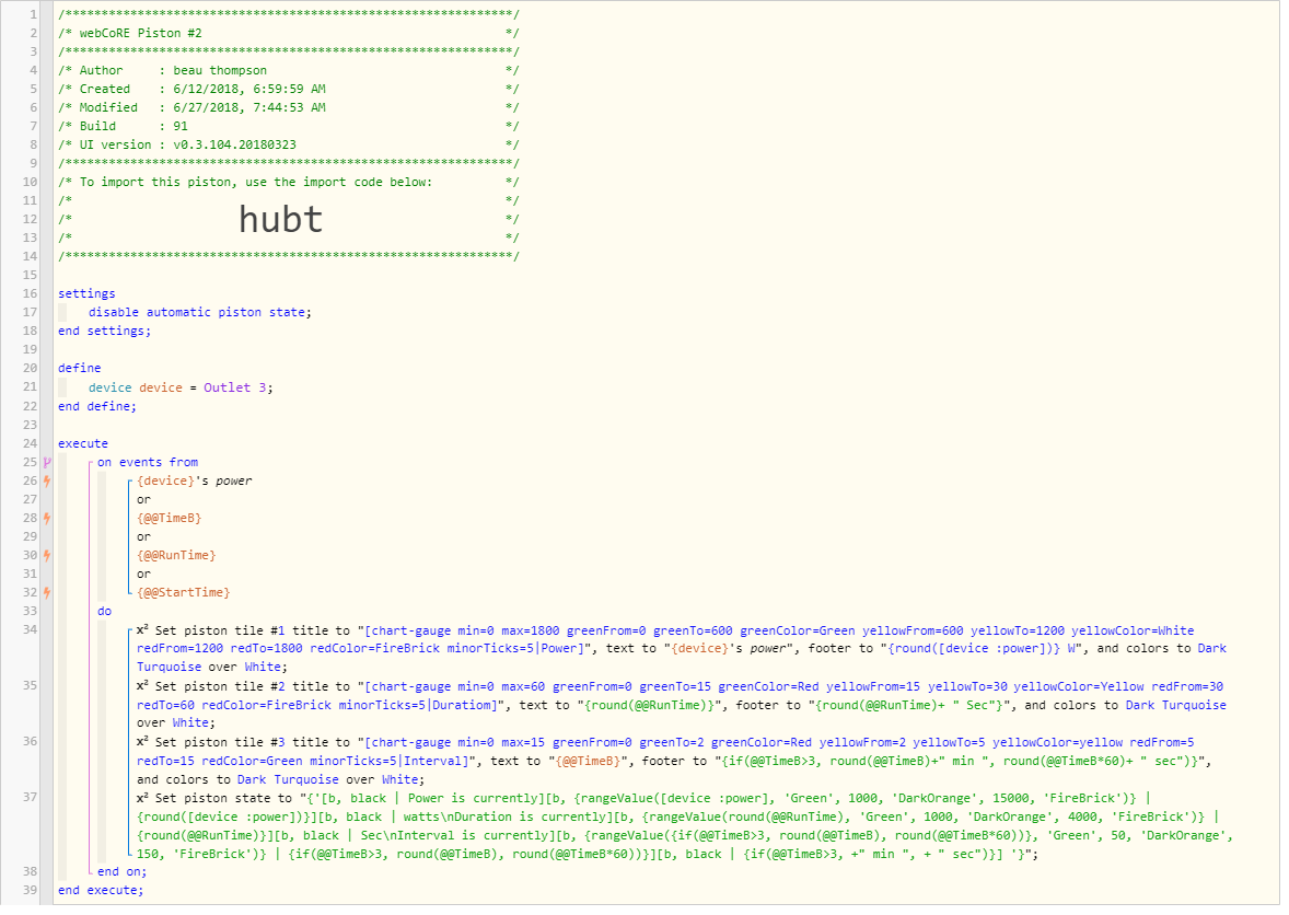

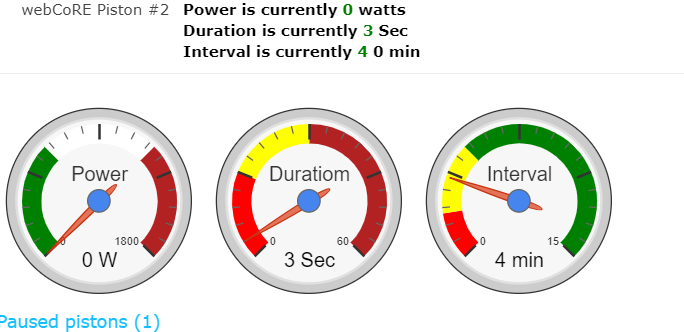

I am have trouble with last line of piston state i went min or sec im get 0 first
went min or sec
get 0 then min or sec
went min or sec
see this last part of the last statement
'...{if(@@TimeB>3, +" min ", +" sec")}]'
if you remove the + that should fix it.
