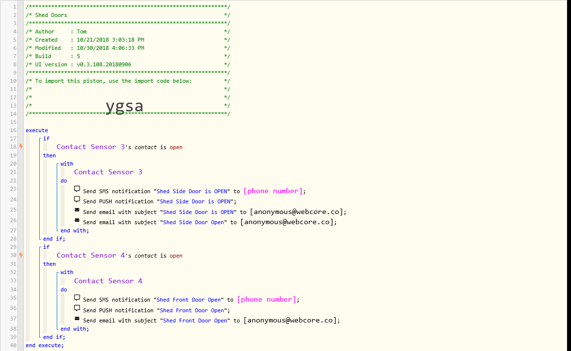

I am trying to get an text, push notification, and email when the doors to my shed are opened.
Receive text, Push Notification and email notification at MSN.COM, Comcast.NET or Gmail.com when door is opened
I am receiving the text and push notification but not any emails.
https://graph-na02-useast1.api.smartthings.com/ide/logs

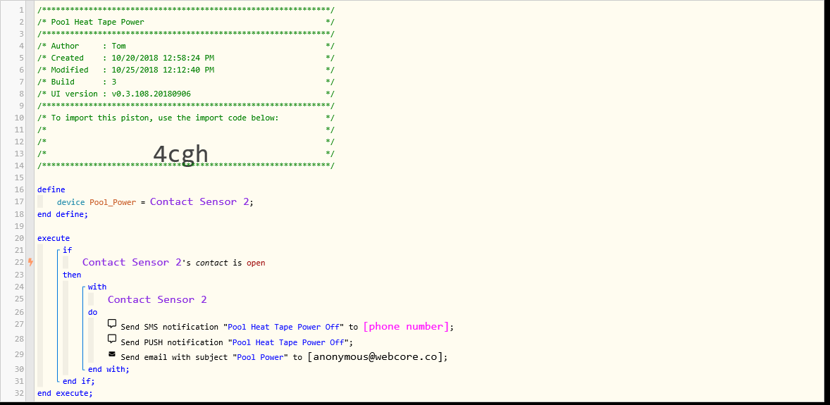

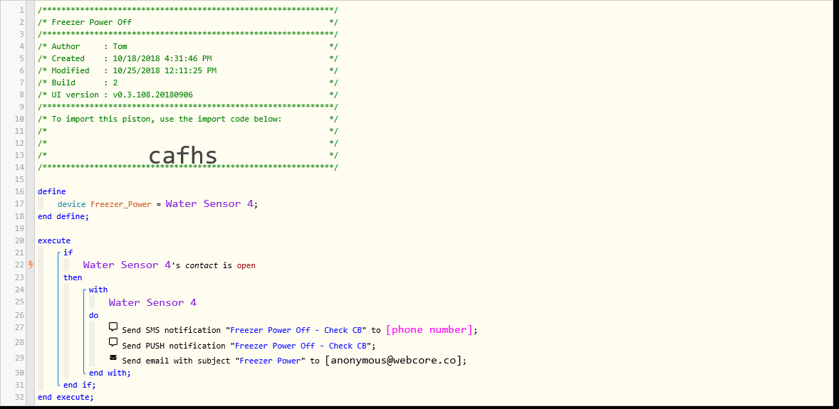

I have two other similar pistons. One of the other pistons does send email
and the other one does not
Both of these use the external connection on GoControl Contact Sensors. The one that does send email uses only the external contact while the one that does not uses both internal and external contacts.
