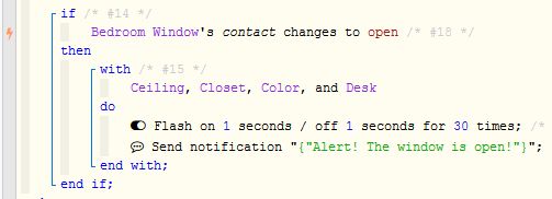

You could do something like this:
I believe the WITH command can have up to 16 lights per command…
I will be honest though… I am not sure how reliable your network / ST hub will be sending 960 commands per minute. If it were me, I would be tempted to pick one dominant light in each room to flash to cut down on network traffic. Also slowing down the flashing would help in that regards as well. The more commands that SmartThings is trying to send at once, the more likelihood that some will not make it thru.

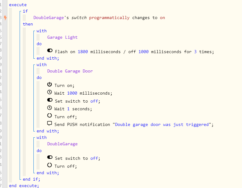

I’ve bee trying to create a similar piston for use with my garage door (i.e. if I trigger garage door to open/close via SmartThings the lights in the garage should flash to warn anyone in the garage). I think I’ve kept the piston fairly simple but for some reason the lights only flash once (I have it set up as your example above with 1 sec intervals and for it to flash 3 times).
Are 1 sec intervals just too quick?
Reading up on some other threads it’s most likely due to the fact that the lights I’m trying to flash are controlled by an in-wall switch (GE on/off) which is probably too slow to cope with the 1 sec intervals. Turns out it’s also a bad idea to flash switches since it can prematurely ruin the internals…
Looks like I’ll have to put a dedicated smart bulb in the mix for my purposes.
Normally, I would say a couple of bulbs could handle this smoothly. (the less bulbs the better)
I usually program flashing commands to be sent to a SmartBulb that is connected to a dumb switch.
What is the precise trigger in your piston? Certain events are only true for a moment.
You could test if your code is working by reducing the flashing to 3 second intervals.
DoubleGarage is a virtual switch (created with ST app) which is the trigger for the piston.
Garage Light is the GE in-wall switch.
Double Garage Door is a smart plug which I’m using to “pulse” a relay that triggers the door to open/close.
I just changed to 3 second intervals and can confirm it all works now - albeit with a less dramatic effect

From my piston snapshot you can see I was making my way there (but from the other side…i.e. trying 1800 ms)
I think for my use-case I would rather be safe than sorry…I wouldn’t want network issues/speed to be the reason why anyone wouldn’t witness the flashing and be in the way of the doors. This trigger will only really be used in pretty limited situations when I need to open/close garage when not in the car…
