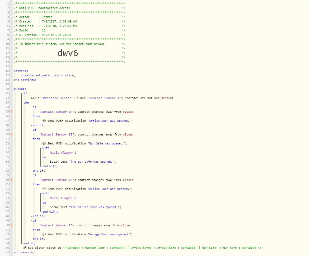

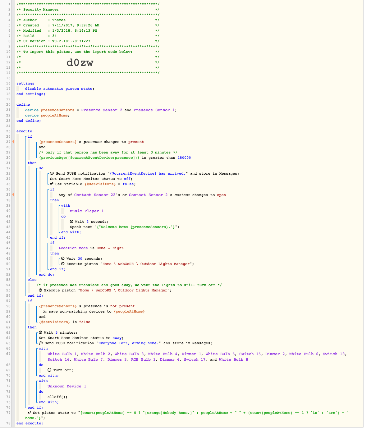

I’m trying to get the text to speech part of this piston (modified version of @ady624 piston) to work so it makes an announcement only when presence is detected and then wait until a specific contact sensor is opened before making the announcement. I’m using a node.js pi3 server to make the API call for text to speech.
No announcement is made when the contact sensor is opened and the presence is detected. I think the piston is attempting to complete but will timeout because the contact sensor doesn’t open in time. I’m guessing I need to introduce a “wait” condition of some form but not sure how.
1/3/2018, 7:16:02 PM +750ms
+1ms ╔Received event [Front Door Sensor].contact = closed with a delay of 424ms
+283ms ║RunTime Analysis CS > 13ms > PS > 48ms > PE > 222ms > CE
+286ms ║Runtime (47967 bytes) successfully initialized in 48ms (v0.2.101.20171227) (284ms)
+287ms ║╔Execution stage started
+302ms ║║Condition #11 evaluated false (11ms)
+303ms ║║Condition group #1 evaluated false (state did not change) (12ms)
+305ms ║║Cancelling statement #2’s schedules…
+316ms ║║Executed virtual command executePiston (7ms)
+332ms ║║Comparison (enum) present is (string) not present = false (2ms)
+335ms ║║Comparison (enum) present is (string) not present = false (1ms)
+339ms ║║Condition #23 evaluated false (20ms)
+340ms ║║Condition group #18 evaluated false (state did not change) (21ms)
+344ms ║║Cancelling statement #29’s schedules…
+360ms ║║Calculating (integer) 2 == (integer) 1 >> (boolean) false
+367ms ║║Calculating (string) Person1 and Person2 + (string) >> (string) Person1 and Person2
+370ms ║║Calculating (string) Person1 and Person2 + (string) are >> (string) Person1 and Person2 are
+373ms ║║Calculating (string) Person1 and Person2 are + (string) home. >> (string) Person1 and Person2 are home.
+376ms ║║Calculating (integer) 2 == (integer) 0 >> (boolean) false
+379ms ║║Executed virtual command setState (0ms)
+380ms ║╚Execution stage complete. (94ms)
+382ms ╚Event processed successfully (381ms)
1/3/2018, 7:15:55 PM +539ms
+1ms ╔Received event [Front Door Sensor].contact = open with a delay of 414ms
+128ms ║RunTime Analysis CS > 12ms > PS > 37ms > PE > 79ms > CE
+131ms ║Runtime (47963 bytes) successfully initialized in 37ms (v0.2.101.20171227) (130ms)
+132ms ║╔Execution stage started
+147ms ║║Cancelling condition #11’s schedules…
+147ms ║║Condition #11 evaluated false (11ms)
+148ms ║║Condition group #1 evaluated false (state did not change) (12ms)
+150ms ║║Cancelling statement #2’s schedules…
+160ms ║║Executed virtual command executePiston (7ms)
+185ms ║║Comparison (enum) present is (string) not present = false (2ms)
+187ms ║║Comparison (enum) present is (string) not present = false (2ms)
+190ms ║║Condition #23 evaluated false (27ms)
+191ms ║║Condition group #18 evaluated false (state did not change) (28ms)
+194ms ║║Cancelling statement #29’s schedules…
+207ms ║║Calculating (integer) 2 == (integer) 1 >> (boolean) false
+213ms ║║Calculating (string) Person1 and Person2 + (string) >> (string) Person1 and Person2
+216ms ║║Calculating (string) Person1 and Person2 + (string) are >> (string) Person1 and Person2 are
+219ms ║║Calculating (string) Person1 and Person2 are + (string) home. >> (string) Person1 and Person2 are home.
+222ms ║║Calculating (integer) 2 == (integer) 0 >> (boolean) false
+225ms ║║Executed virtual command setState (0ms)
+227ms ║╚Execution stage complete. (95ms)
+228ms ╚Event processed successfully (227ms)
1/3/2018, 7:08:37 PM +857ms
+1ms ╔Received event [Person2].presence = present with a delay of 80ms
+190ms ║RunTime Analysis CS > 19ms > PS > 97ms > PE > 74ms > CE
+193ms ║Runtime (47897 bytes) successfully initialized in 97ms (v0.2.101.20171227) (192ms)
+194ms ║╔Execution stage started
+207ms ║║Comparison (enum) present changes_to (string) present = true (0ms)
+209ms ║║Cancelling condition #11’s schedules…
+209ms ║║Condition #11 evaluated true (10ms)
+227ms ║║Comparison (long) 102124 is_greater_than (integer) 180000 = false (1ms)
+229ms ║║Condition #12 evaluated false (18ms)
+229ms ║║Condition group #1 evaluated false (state did not change) (30ms)
+232ms ║║Cancelling statement #2’s schedules…
+241ms ║║Executed virtual command executePiston (5ms)
+252ms ║║Comparison (enum) present is (string) not present = false (1ms)
+254ms ║║Comparison (enum) present is (string) not present = false (1ms)
+258ms ║║Condition #23 evaluated false (14ms)
+259ms ║║Condition group #18 evaluated false (state did not change) (15ms)
+261ms ║║Cancelling statement #29’s schedules…
+397ms ║║Calculating (integer) 2 == (integer) 1 >> (boolean) false
+404ms ║║Calculating (string) Person1 and Person2 + (string) >> (string) Person1 and Person2
+407ms ║║Calculating (string) Person1 and Person2 + (string) are >> (string) Person1 and Person2 are
+411ms ║║Calculating (string) Person1 and Person2 are + (string) home. >> (string) Person1 and Person2 are home.
+413ms ║║Calculating (integer) 2 == (integer) 0 >> (boolean) false
+416ms ║║Executed virtual command setState (0ms)
+418ms ║╚Execution stage complete. (224ms)
+420ms ╚Event processed successfully (419ms)
