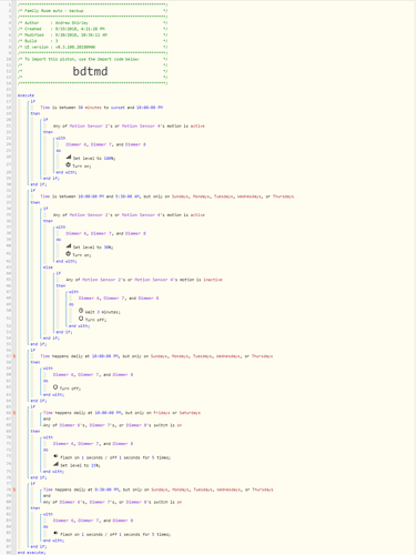

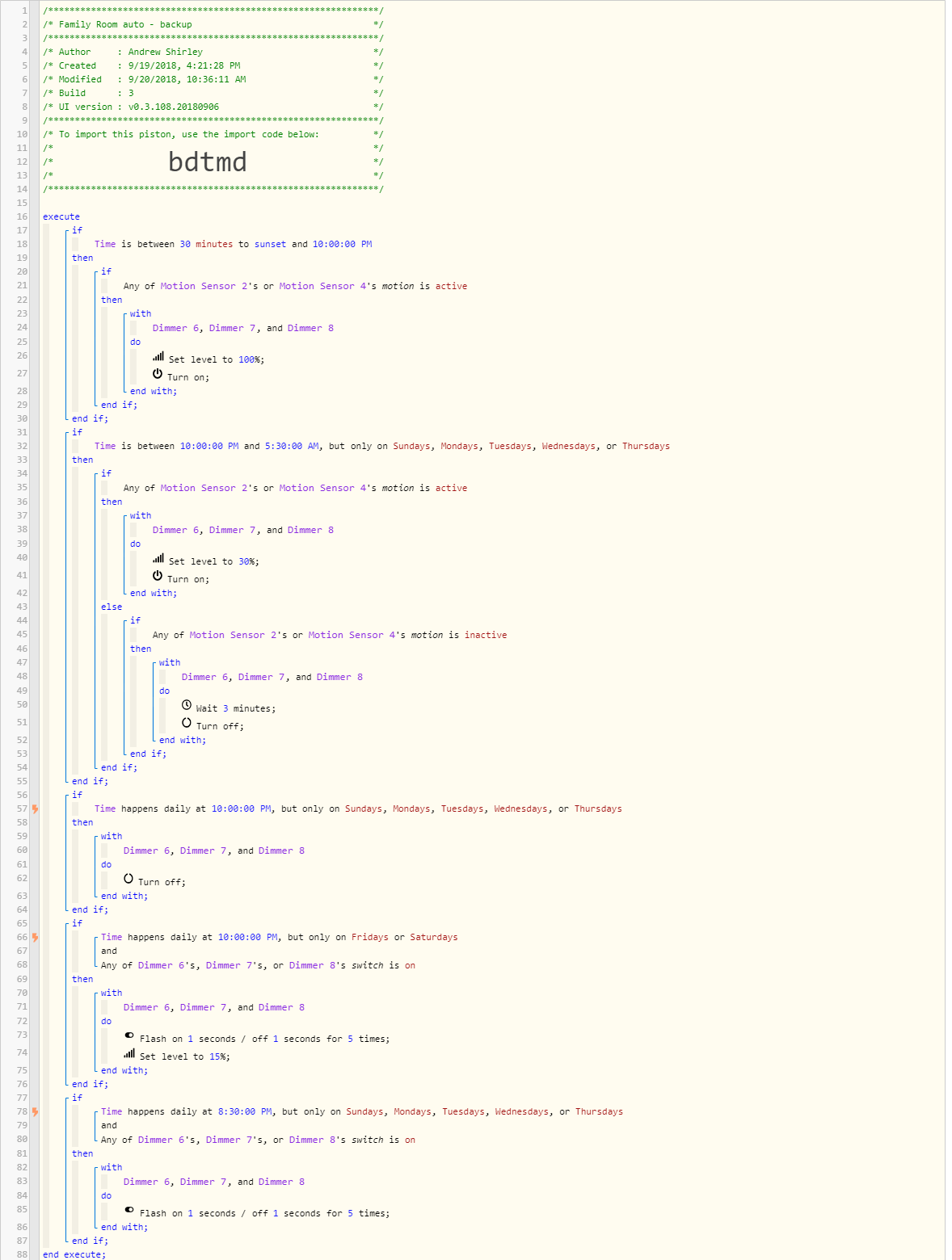

Need help, part of piston not firing
Part of the piston isn’t firing. The blocks not running are #1 and #22
Only blocks #37, #47 and #53 are running.
I’ve also noticed that I have the lightning bolt next to blocks #37, #47 and #53
Block #1 should run between 30 minutes before sunset and 10 pm. If motion is detected on either 2 motion sensors, set the level of the 3 lights to 100% and turn them on.
Block #22 runs between 10 pm and 5:30 am, but only on Sun, Mon, Tue, Wed or Thurs. If motion is detected on either 2 motion sensors, set the level of the 3 lights to 30% and turn them on. If no motion is detected on either 2 motion sensors, wait 3 minutes and turn them off
Block #37 turns the lights off at 10 pm, but only on Sun, Mon, Tues, Wed or Thur.
Block #47 will flash the lights at 10 pm only on Fri or Sat, for 5 seconds, change the level to 15%.
Block #53 will flash the lights at 8:30 pm only on Sun, Mon, Tues, Wed or Thur
I’ve tried creating a test piston with only blocks #1 and #22. In the test, they work fine.
Expect lights to turn on/off based on time and days of the week, along with the other blocks that are functioning.
Blocks #1 and #22 are not running at all, even when the time should trigger them.
(UPLOAD YOUR IMAGE HERE)

The numbers you mentioned are not in your attached picture, but I think I see what is going on here.

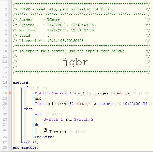

I usually put the motion detect at the top level (far left with no indenting), and use time as a condition. This will create the lightning bolt next to the motion detect, and will only run that block of code if the time matches.
Like this:
temp
(also note I changed it to say if motion CHANGES TO active)
I would change the first if (line 17) to a “only when”. this will run the 2nd if (line 20) in the first statement ‘only when’ the time falls between your range.
I would also do this for your second statement, starting on line 31.
if there is no lightning bolt next to the if statement, then it will not be triggered.
That got it. Thanks for the help!
