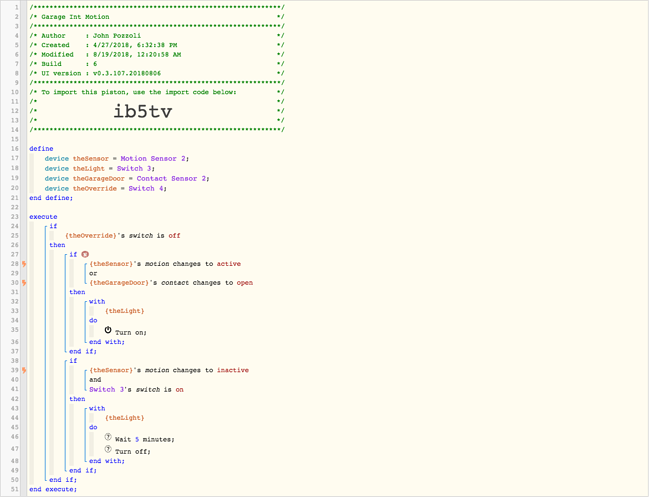

I have a light switch in my garage with a GE smart switch. I also have a motion detector in there and a door contact sensor. When the light is turned on from the opening of the door, it never shuts off. If the light is turned on from the motion sensor, it shuts off after 5 min. as programmed.
In the first IF, you have TCP set to never. (The small red N).
In the second IF you haven’t. Set the second IF’s TCP to never.

Forget the TCP change.
Change the second IF from changes to Inactive, to is inactive.
OR remains inactive for 5 minutes and then delete the wait 5 minutes.
Thanks. Made the changes you recommended and will test.
As for the variables, that’s how I see a lot of scripts written, just trying to follow suit.
I don’t know the distance between your motion sensor & door, but in your code, there’s no mention of:
“turn off the light when the garage door closes”
In other words, if the door is opened (and if you are able to keep outside the range of the motion sensor) the light will never turn off.
You could resolve this by adding this block to the end of the piston:
If {theGarageDoor}'s contact remains closed for 5 minutes
then
    with {theLight}
    do Turn off
end if
