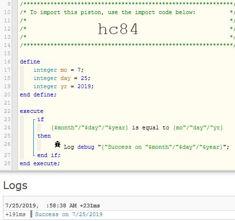

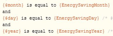

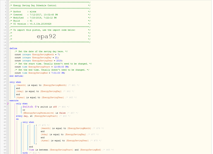

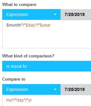

I’m trying to make a piston run on a particular, single day, with a start time and an end time. My energy suppliers have “energy saving days”. They only last for a day and the saving time, when we are to reduce consumption is from 1p to 7p, typically. The problem is I can’t figure out how to get it to run just on the day specified. Not the day before or after. My only choices are:
IS AFTER (this doesn’t work because I want it to run for just one day and not any days after)
IS BEFORE (this doesn’t work because I want it to run the next day not the preceding day)
IS ANY (this doesn’t work because I want it to run for just one day, not on any old day)
IS BETWEEN (this doesn’t work because I only need a single day. I did try making both the between dates the same but that seemed to make it run like IS ANY. I also only want to program it for a single day, not give it a day before and after, that seems silly)
IS NOT BETWEEN (opposite behavior from what I want.)
HAPPENS DAILY AT (I want to set a date, not a time. I tried it and it seem to only run at midnight, not at the times I specified.)
It seems strange that there is no IS or IS EQUAL TO as a selection.
TO SUM UP: How do I make a piston run only on an given single date.
Piston will only run on the single specified day. Not the days before and after and don’t want to program 2 different days to get it to run on the day I want.
It does run when I need it to, but it is also running on days, before and after, that I don’t.
Also note that the pistons called out “nest away” and “nest home” are used to catpure and reset the nest to the same settings before and after the event. I am just re-using it here but it is usually run when everyone leaves or returns to the house.
Don’t know how much it helps but here are the most current.
