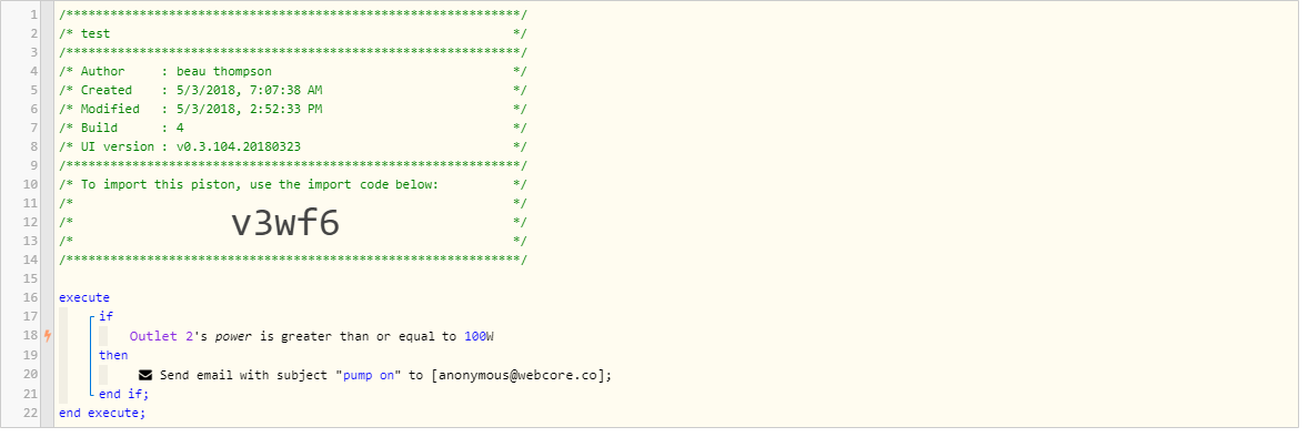

hi my code work ok i need help with email body i wet it to have current time and date ad one of the tags from pump 2 i am not sure how to do it
Need help with email body

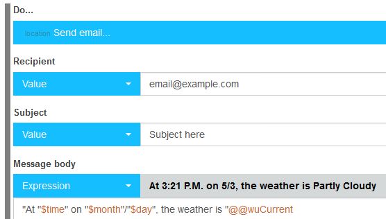

Something like this should work as an expression.
Normal text is in quotes… but variables are outside the quotes.
@@wuCurrent is a global variable of mine.
