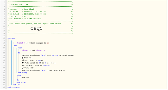

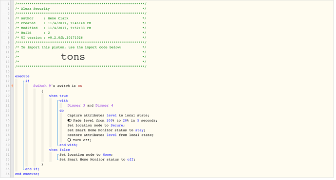

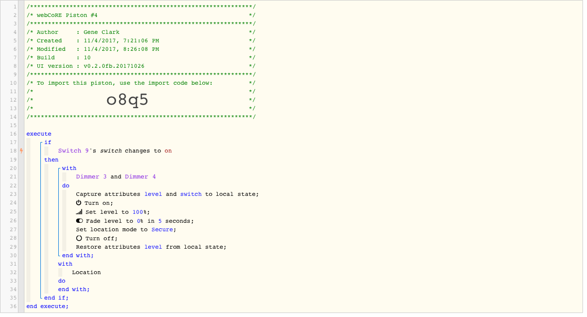

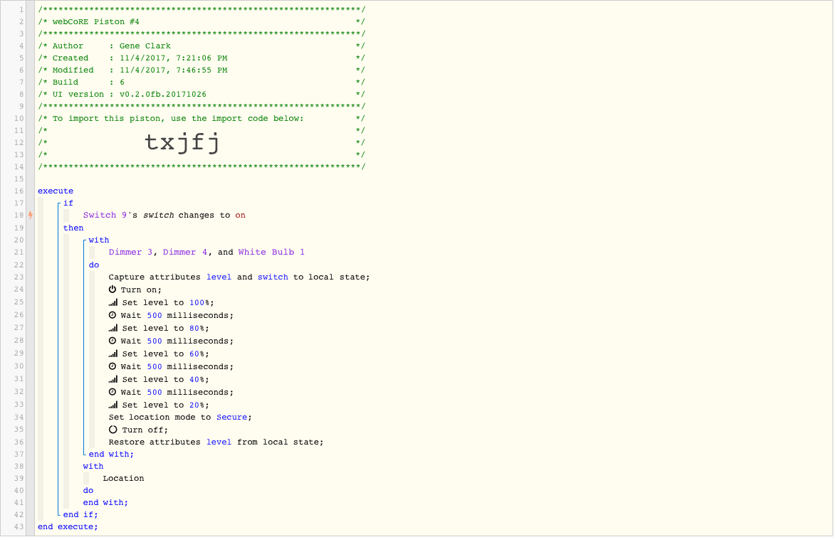

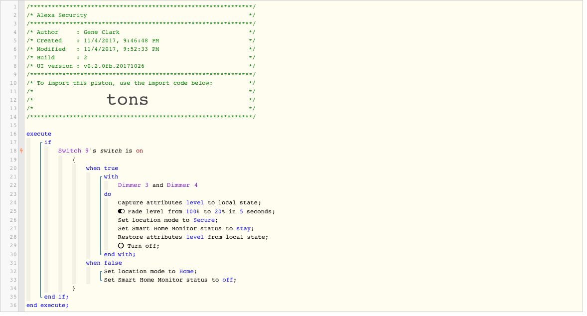

Questioning how to best code fading of light and restoration of dim level not working.
Want lights to go back to original dim level
Lights come back on at 20% which is last state set in piston

`3ffd564f-49d2-4069-9791-00425489e46d 8:02:29 PM: trace ║╔ Execution stage complete. (2564ms)
3ffd564f-49d2-4069-9791-00425489e46d 8:02:29 PM: debug ║║ Restoring attribute ‘level’ to value ‘50’ using command setLevel(50)
3ffd564f-49d2-4069-9791-00425489e46d 8:02:29 PM: debug ║║ Skipped execution of physical command [Bedroom Lamp].setLevel([20]) because it would make no change to the device. (7ms)
3ffd564f-49d2-4069-9791-00425489e46d 8:02:29 PM: debug ║║ Skipped execution of physical command [Stove Light].setLevel([50]) because it would make no change to the device. (7ms)
3ffd564f-49d2-4069-9791-00425489e46d 8:02:29 PM: trace ║║ Executed virtual command [Bedroom Lamp, Lamp, Stove Light].setLocationMode (39ms)
3ffd564f-49d2-4069-9791-00425489e46d 8:02:29 PM: debug ║║ Restoring attribute ‘level’ to value ‘20’ using command setLevel(20)
3ffd564f-49d2-4069-9791-00425489e46d 8:02:29 PM: trace ║║ Executed [Lamp].off (16ms)
3ffd564f-49d2-4069-9791-00425489e46d 8:02:29 PM: debug ║║ Skipped execution of physical command [Lamp].setLevel([50]) because it would make no change to the device. (6ms)
3ffd564f-49d2-4069-9791-00425489e46d 8:02:29 PM: trace ║║ Executed [Bedroom Lamp].off (18ms)
3ffd564f-49d2-4069-9791-00425489e46d 8:02:29 PM: debug ║║ Executed physical command [Stove Light].setLevel([20]) (15ms)
3ffd564f-49d2-4069-9791-00425489e46d 8:02:29 PM: trace ║║ Executed [Stove Light].setLevel (16ms)
3ffd564f-49d2-4069-9791-00425489e46d 8:02:29 PM: debug ║║ Executed physical command [Lamp].off() (15ms)
3ffd564f-49d2-4069-9791-00425489e46d 8:02:29 PM: trace ║║ Executed [Lamp].setLevel (16ms)
3ffd564f-49d2-4069-9791-00425489e46d 8:02:29 PM: debug ║║ Skipped execution of physical command [Bedroom Lamp].setLevel([20]) because it would make no change to the device. (5ms)
3ffd564f-49d2-4069-9791-00425489e46d 8:02:29 PM: debug ║║ Executed physical command [Stove Light].setLevel([40]) (15ms)
3ffd564f-49d2-4069-9791-00425489e46d 8:02:29 PM: trace ║║ Executed virtual command [Bedroom Lamp, Lamp, Stove Light].wait (0ms)
3ffd564f-49d2-4069-9791-00425489e46d 8:02:29 PM: trace ║║ Executed virtual command [Lamp].loadStateLocally (17ms)
3ffd564f-49d2-4069-9791-00425489e46d 8:02:29 PM: info ╔ Event processed successfully (2704ms)
3ffd564f-49d2-4069-9791-00425489e46d 8:02:28 PM: trace ║║ Waiting for 500ms
3ffd564f-49d2-4069-9791-00425489e46d 8:02:29 PM: debug ║║ Executed physical command [Stove Light].off() (15ms)
3ffd564f-49d2-4069-9791-00425489e46d 8:02:28 PM: trace ║║ Executed [Stove Light].setLevel (17ms)
3ffd564f-49d2-4069-9791-00425489e46d 8:02:29 PM: debug ║║ Cancelling statement #14’s schedules…
3ffd564f-49d2-4069-9791-00425489e46d 8:02:29 PM: trace ║║ Executed virtual command [Bedroom Lamp].loadStateLocally (18ms)
3ffd564f-49d2-4069-9791-00425489e46d 8:02:28 PM: debug ║║ Executed physical command [Lamp].setLevel([60]) (15ms)
3ffd564f-49d2-4069-9791-00425489e46d 8:02:29 PM: trace ║║ Executed [Stove Light].off (17ms)
3ffd564f-49d2-4069-9791-00425489e46d 8:02:28 PM: info smartapp_pause called by smartAppName=webCoRE Piston, value=500, smartAppVersionId=eba4eb9d-4efd-4bc8-b849-8f781f767758
3ffd564f-49d2-4069-9791-00425489e46d 8:02:29 PM: trace ║║ Executed virtual command [Stove Light].loadStateLocally (18ms)
3ffd564f-49d2-4069-9791-00425489e46d 8:02:29 PM: trace ║║ Executed [Bedroom Lamp].setLevel (6ms)
3ffd564f-49d2-4069-9791-00425489e46d 8:02:28 PM: debug ║║ Executed physical command [Bedroom Lamp].setLevel([60]) (15ms)
3ffd564f-49d2-4069-9791-00425489e46d 8:02:29 PM: debug ║║ Executed physical command [Bedroom Lamp].off() (17ms)
3ffd564f-49d2-4069-9791-00425489e46d 8:02:29 PM: info smartapp_pause called by smartAppName=webCoRE Piston, value=500, smartAppVersionId=eba4eb9d-4efd-4bc8-b849-8f781f767758
3ffd564f-49d2-4069-9791-00425489e46d 8:02:29 PM: debug ║║ Executed physical command [Lamp].setLevel([20]) (15ms)
3ffd564f-49d2-4069-9791-00425489e46d 8:02:28 PM: trace ║║ Executed [Stove Light].setLevel (18ms)
3ffd564f-49d2-4069-9791-00425489e46d 8:02:29 PM: trace’
