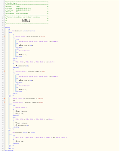

You may want to enable trace and also provide logs.
Does the following actually show as true? Feels like the state of both can not occur together.
Can motion sensor 4 motion changes to inactive
And
contact sensor 1 contact changes to closed

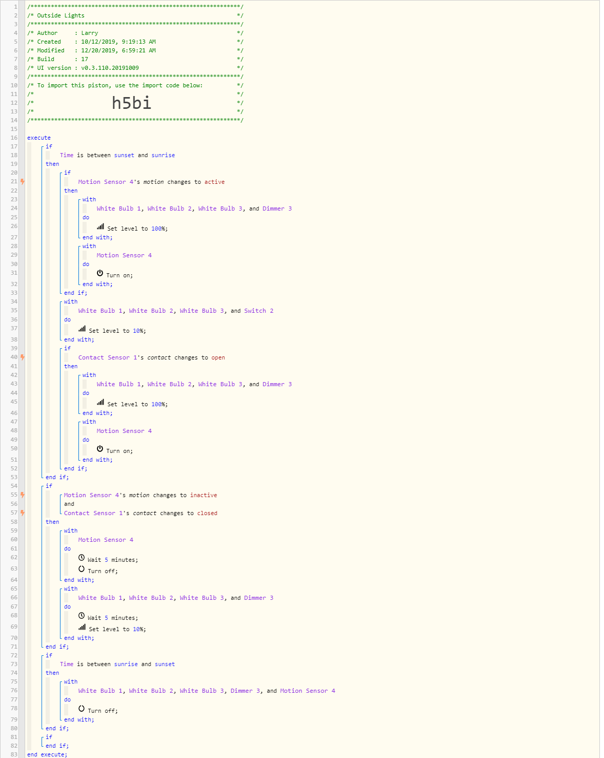

Several things about this piston make no sense to me. Maybe it is just me. Here is my 2 cents worth.
  1. If MS4 is active you turn on MS4. It sounds like you are turning on something that is already on.
  2. If MS4 is active you set lights to 100%. Then immediately they are set to 10% after If Statement.
  3. The If statement that checks for MS4 and CS1 changing at exactly the same time is probably never going to happen.
  4. I’m not 100% sure, but I think your WAIT statement terminates whenever ANY trigger fires within the piston. There are non-default piston setting to keep this from happening.
As @Dale mentioned I believe you need to re-think your strategy here. Your first part of an if should be some kind of a trigger.
I think using “IF time between sunset and sunrise” as the start of your IF is not a good idea.
I would start with the sensor change then look at the time and decide what to do.

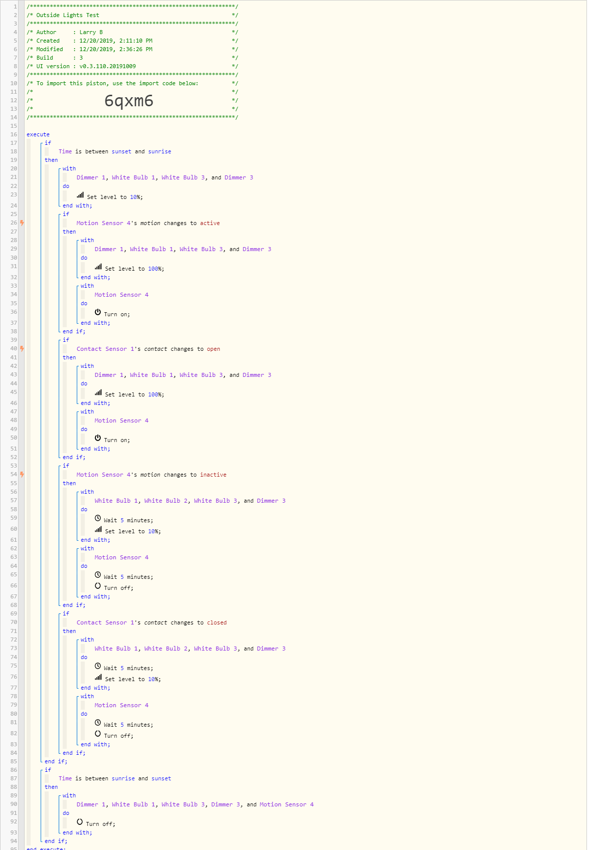

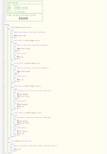

Ok so I have the time as the initial trigger because at sunset, I want the lights to set to 10% and stay at 10% until motion is sensed or the door opens. When motion is sensed or the door opens, I want the lights to go from 10% to 100% and the motion sensor switch to turn on (The motion sensor has a built in switch that turns on large flood lights) When there is no motion for 5 minutes, I want the motion sensor switch to turn off the flood lights and the other lights dim to 10%. At sunrise, I want everything to turn off until Sunset.
Does this look better. Remember that “Motion Sensor 4” is a motion sensor and a physical switch.
What you have is a condition. You need a trigger.
Time happens daily at Sunset would be a trigger.
Pistons do not sit and run indefinitely it needs to start.
If time is between sunset and sunrise would be a big window of time for the piston to constantly run and watch for a sensor to change.
I am no expert but I have the best luck when I start the piston from the device I am watching.
If sensor changes to active then
if time between
do something

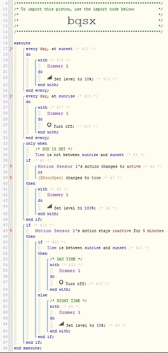

Maybe try something like this:
Remember that a piston executes from top to bottom every time one of the “lightning Bolt” events happens or a timer event happens.

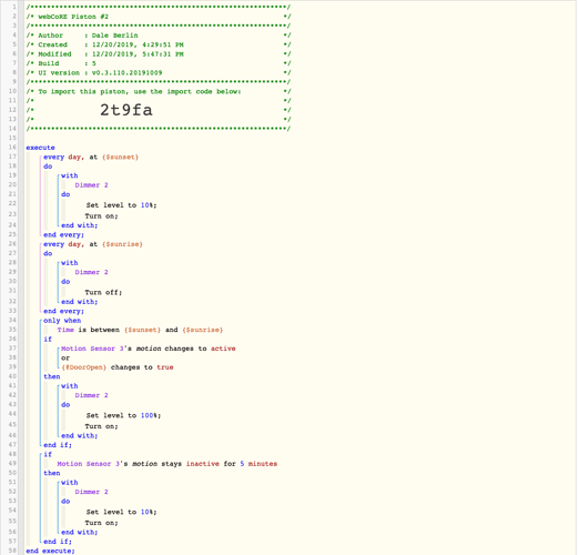

@Dale is definitely on the right track…
I made a few small changes to his code to account for the early morning possibility of running past sunrise.
Good catch WC
What does “early morning running past sunrise” mean. Isn’t sunrise and sunset a set time everyday?
In piston 2t9fa above, there may be occasions where the light is left on all day.
(line 49 could be true at any time)
Piston bqsx fixes that…
