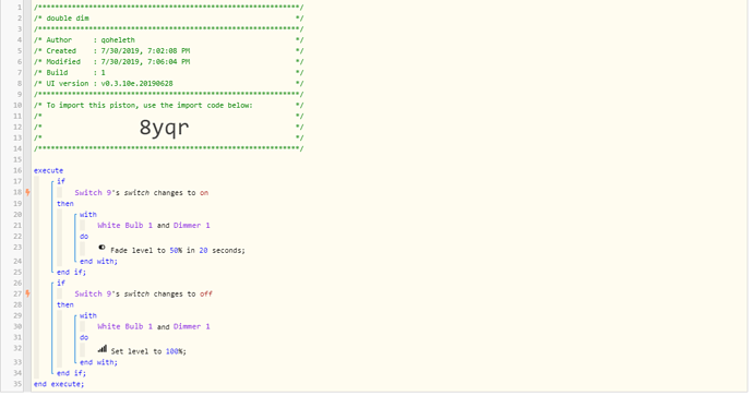

Thanks @qoheleth! Will this work regardless of whether or not either device is on or off?
Each brand might react differently but dimmers I use have a SET LEVEL command. Wheter they are ON or OFF set level to 50 will turn them ON and make it 50 OR if they are ON will dim lights down to 50.
Test this out. It it’s a yes your piston will be very easy and simple.

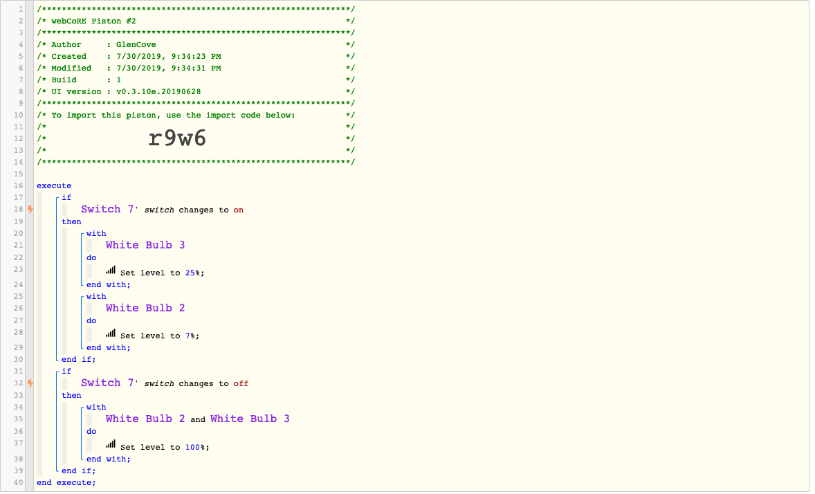

Okay, I think it’s working now. I had to use “Set Level” for each DO statement. Now to complicate things, can I use a different dim percent for Room 1? For example, 25% in Room 1, 10% in Room 2?
Yes you can…
Just take a look at @qoheleth piston, You can add new WITH/DO blocks for other rooms and different dim levels…

Thanks @ike2018… how do I share my piston so you can see it?
You will see green camera button on top of your piston. Click on that. Save it as a picture and upload it here.
Thanks, this seems to work.
Looks good:)
Thanks for the help! I’ll test it with different scenarios that include either room being on or off before I execute the piston. What I had previously worked, but the lights in each room needed to be on first.
After testing different scenarios, the only thing that trips this up is if my virtual switch is on and the dimmed lights are on. If someone turns off one of the rooms lights accidentally, the lights for that room have to be turned back on. It would be nice if I could just execute the virtual switch again and force it to turn the lights back on if they’re off. Thanks
1 - So my understanding from your last post is, if dimmer is turned OFF manually, setting LEVEL in the piston won’t turn the lights ON… is that correct?

a) You can add TURN ON command to your piston before level settings. And activate the dimmer first.
b) You can use magnetic caps on the dimmers.
My house is full of these because of accidental turn OFF situations.
You can easily lift it and turn it ON/OFF but no accidentals,
