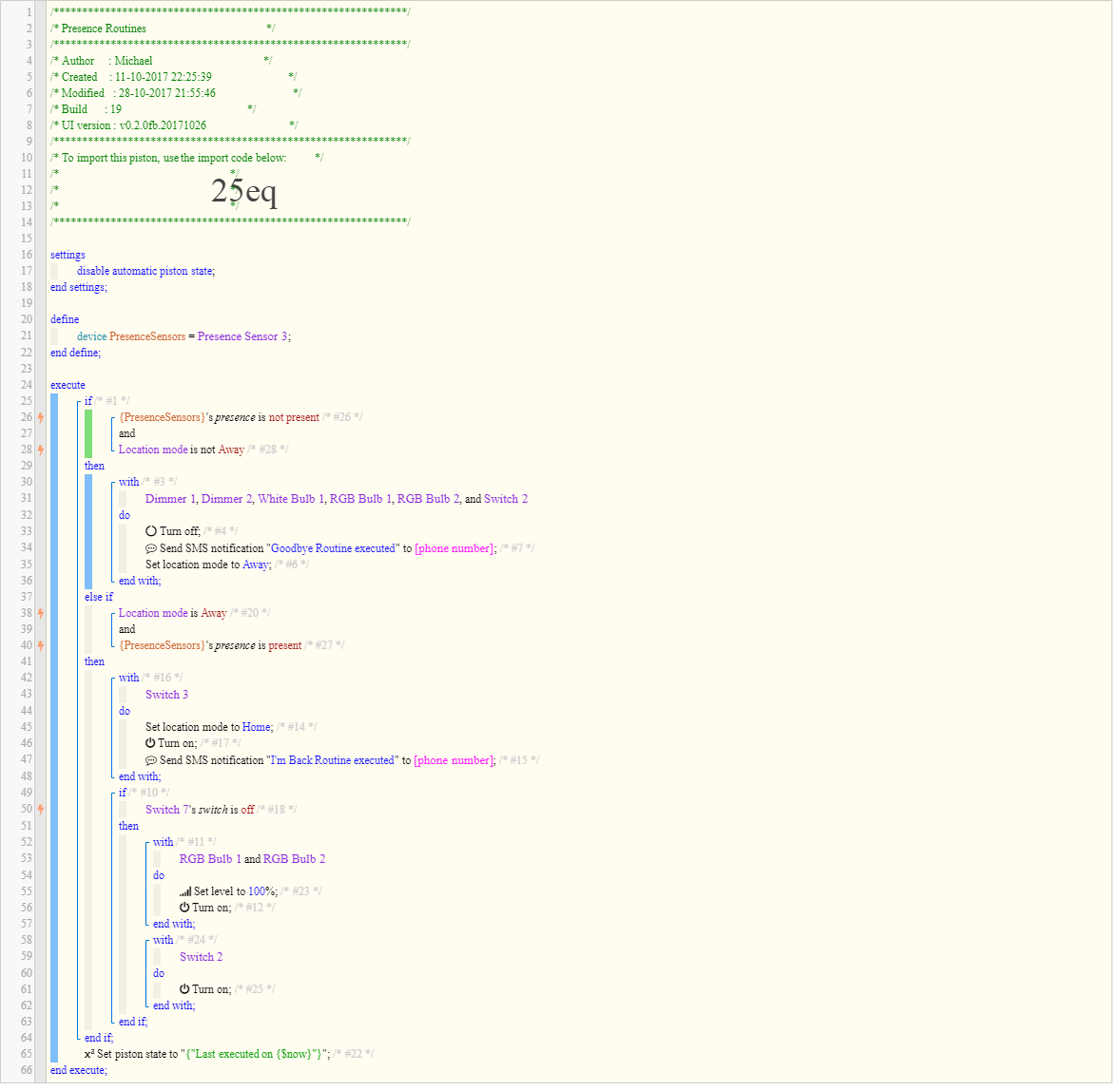

I think you want “presence changes to present”, use the trigger.
But wont that trigger everytime one of us comes home since its an or statement?
Change the “any of” to all:
And be sure to make a else if for the goodbye part.

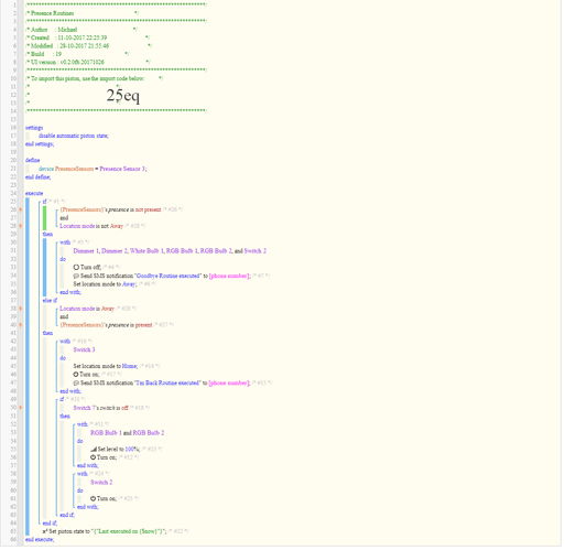

Here is my presence routine:
Thank you both for your help.
I added both suggestions, hopefully it will work now! Adding the condition for the house to be in away mode was a great idea also. Then if I am still home and my wife leaves it wont trigger on me.
