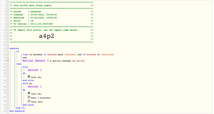

I’d like to turn on the flood lights for 5 minutes when the motion sensor detects motion. Is this the best way to accomplish this? Thanks!
Need help with simple motion activate flood lights

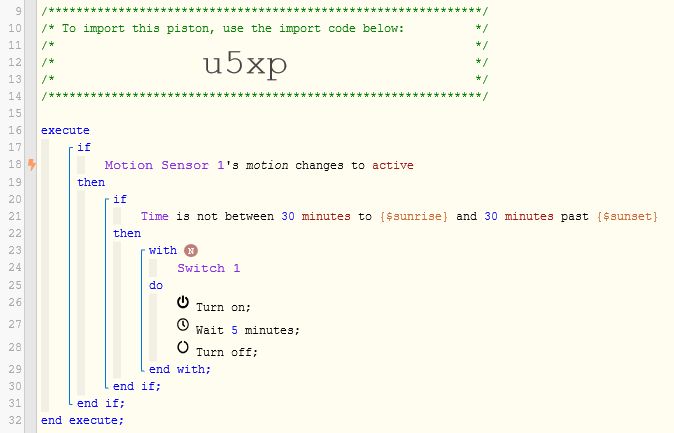

Here is how I would do it:
I inverted the times (which spans midnight), indented an IF, and removed an extraneous command.

Thanks! That looks cleaner and makes sense about how to handle midnight. I’ll give it a try!
