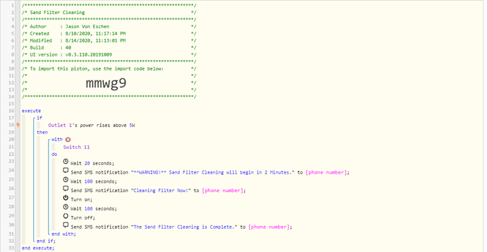

Need to count how many times a piston runs and report via SMS
I would like the SMS that is sent to me to show how many times it has run that day.
The last SMS message…i.e. “The Sand Filter Cleaning is Complete (1)” or (2) or etc…
I have tried looking at some similar topics but I cannot replicate or find one similar enough to copy. :frowning:
No logs as this current piston runs fine now.

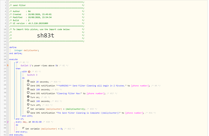

Hi Robin, Thank you for your help.
I am kind of new at this and I am not entirely sure how to add this integer and the dailycounter to the piston. If you or someone is able to outline some of the steps that would be much appreciated.
Cheers
It worked great. Thank you so much for the video. That was very helpful.

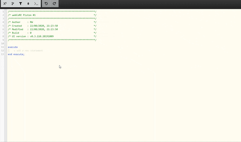

It’s just a GIF. I use:
Then I upload it to giphy.com and paste the link into the forum.
Pictures speak a thousand words lol
