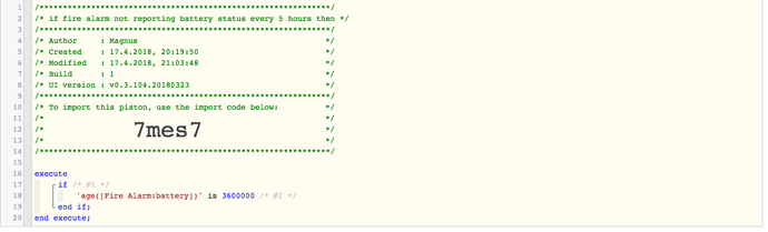

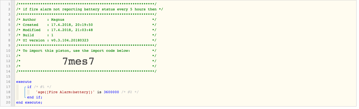

I´m really terrible at this, and just done a few simple things in webcore before, am I on the right track here you think? I wrote it as a value.
this is the log;
17.4.2018, 21:07:21 +53ms
+0ms ╔Received event [Snippen].test = 1523992041052 with a delay of 0ms
+62ms ║RunTime Analysis CS > 16ms > PS > 35ms > PE > 12ms > CE
+64ms ║Runtime (36194 bytes) successfully initialized in 35ms (v0.3.104.20180323) (63ms)
+65ms ║╔Execution stage started
+73ms ║║Comparison (string) age([Fire Alarm:battery]) is (integer) 3600000 = false (1ms)
+75ms ║║Condition #2 evaluated false (4ms)
+75ms ║║Condition group #1 evaluated false (state did not change) (6ms)
+80ms ║╚Execution stage complete. (15ms)
+81ms ╚Event processed successfully (82ms)

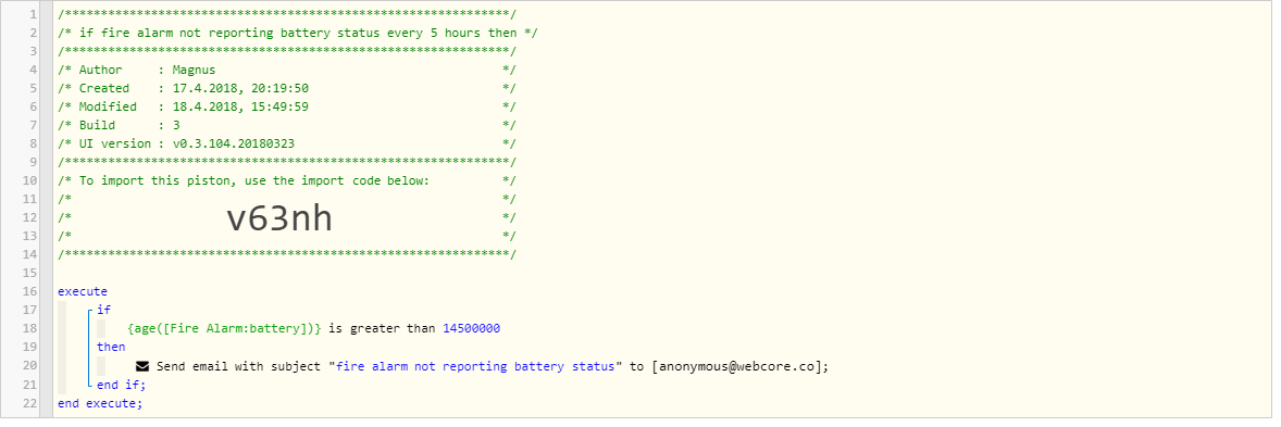

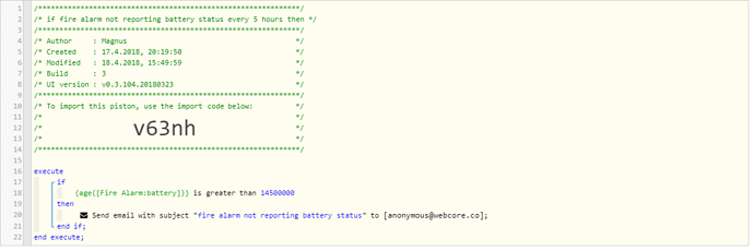

I had to change it to an expression. I added the code as a value in the first test.
Here is a picture of the code
here is a cut from the log:
+2ms ╔Received event [Snippen].test = 1524059413624 with a delay of 0ms
+76ms ║RunTime Analysis CS > 16ms > PS > 43ms > PE > 17ms > CE
+80ms ║Runtime (37140 bytes) successfully initialized in 43ms (v0.3.104.20180323) (77ms)
+95ms ║║Comparison (long) 13323644 is_greater_than (integer) 14500000 = false (2ms)
+96ms ║║Condition #2 evaluated false (11ms)
+98ms ║║Condition group #1 evaluated false (state did not change) (13ms)
+100ms ║╚Execution stage complete. (19ms)
+102ms ╚Event processed successfully (102ms)
