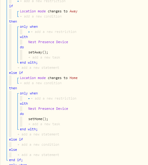

So simple it seems to be able to set Nest Away when me and the GF leave
But GF just came home, Location mode is on, but nest still say Away
(PS in the Smarththings it says home, but in the nest APP it still says away)
Use Nest Thermostat instead of Nest Presence Device in your piston. I do not even use the nest presence device. I simply use the ST presence as I found there to be conflicts/inaccuracies when using both.
