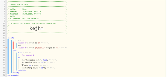

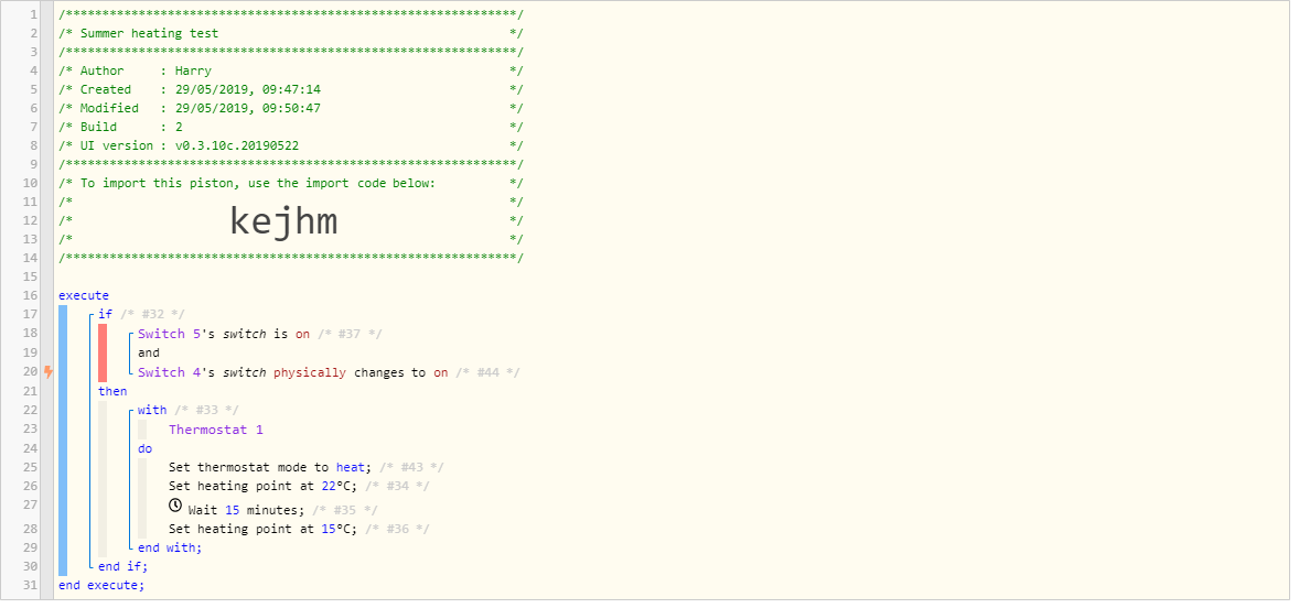

I’ve recently noticed Nest isn’t updating to the Heating Set Point as set via webcore/smartthings.
Webcore sets the setpoint to say 25deg (roasting warm, yes I know), and smartthings IDE updates to set point 25deg but the actual Nest device is not updating, nor is the heating kicking in.
As above, Nest is not updating to command.

29/05/2019, 09:50:59 +617ms
+1ms ╔Received event [Test].switch = on with a delay of 102ms
+70ms ║RunTime Analysis CS > 18ms > PS > 27ms > PE > 25ms > CE
+73ms ║Runtime (40274 bytes) successfully initialized in 27ms (v0.3.10b.20190514) (70ms)
+88ms ║║Comparison (enum) on is (string) on = true (2ms)
+90ms ║║Condition #37 evaluated true (10ms)
+95ms ║║Comparison (enum) on changes_to (string) on = true (1ms)
+97ms ║║Cancelling condition #44’s schedules…
+98ms ║║Condition #44 evaluated true (7ms)
+100ms ║║Cancelling condition #32’s schedules…
+101ms ║║Condition group #32 evaluated true (state changed) (21ms)
+104ms ║║Cancelling statement #33’s schedules…
+115ms ║║Skipped execution of physical command [Nest Thermostat - Dining Room].setThermostatMode([heat]) because it would make no change to the device. (4ms)
+116ms ║║Executed [Nest Thermostat - Dining Room].setThermostatMode (6ms)
+7073ms ║║Executed physical command [Nest Thermostat - Dining Room].setHeatingSetpoint([22.0]) (6953ms)
+7075ms ║║Executed [Nest Thermostat - Dining Room].setHeatingSetpoint (6955ms)
+7079ms ║║Executed virtual command [Nest Thermostat - Dining Room].wait (1ms)
+7081ms ║║Requesting a wake up for Wed, May 29 2019 @ 10:06:06 AM BST (in 900.0s)
+7086ms ║╚Execution stage complete. (7013ms)
+7088ms ║Setting up scheduled job for Wed, May 29 2019 @ 10:06:06 AM BST (in 899.995s)
+7101ms ╚Event processed successfully (7100ms)
