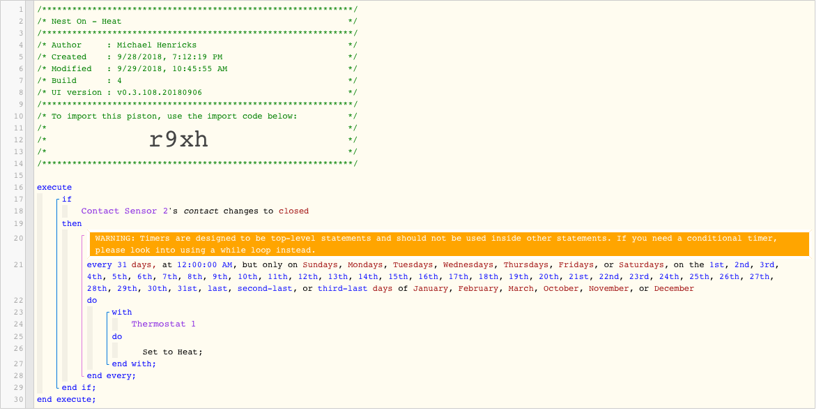

Got a snapshot of your piston?
Here is what I have…
I am sure I set the schedule up wrong, as I have no clue what I am doing with that…lol!
image|690x346
Also, what device handler are you using for your Nest?
Let me try the pic again. I am using what ever device managers that came with NST Manager.
Ok, you need to heed the warning about using timers at the top-level only, otherwise you’re going to run into some event-related issues.
Anyway, I THINK you want this to run only in the months of October through March, since you’ve got every option checked off for only those months, LOL. Create a new piston (Restore a piston using a backup code) using the import code, below:
Substitute your contact sensor and the Nest for the devices in the piston. If the “resumeProgram()” statement in line 25 is still valid when you import this piston, it might work with the Nest and NST Manager … if not, you’ll need another method to return the Nest to the previous state (if possible.)
I don’t have a Nest thermostat to test this. You can include September in the months list to test it now.
Awesome! Thank you! It worked!
