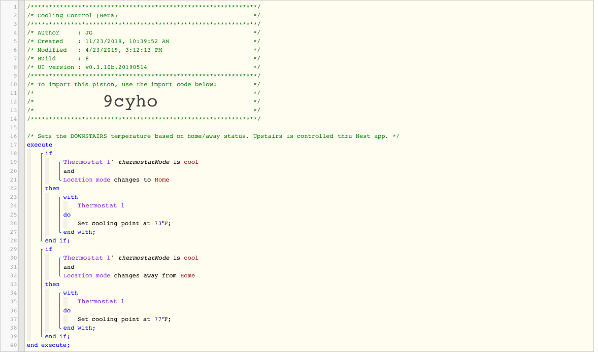

After switching to webcore from core my downstairs thermostat cooling piston no longer works
This simple piston is supposed to set the temperature when in cooling mode based on SmartThings mode.
Temperature is not changing

According to your log:
11:50:24 PM = [Gates Homestead].mode = Home
11:50:24 PM = [Nest Thermostat - Downstairs].setCoolingSetpoint([73.0])
… 19 seconds later …
11:50:45 PM = [Gates Homestead].mode = Night
11:50:45 PM = [Nest Thermostat - Downstairs].setCoolingSetpoint([77.0])
… 6 minutes later …
11:56:56 PM = [Gates Homestead].mode = Home
11:56:56 PM = [Nest Thermostat - Downstairs].setCoolingSetpoint([73.0])
… 17 seconds later …
11:57:13 PM = [Gates Homestead].mode = Night
11:57:13 PM = [Nest Thermostat - Downstairs].setCoolingSetpoint([77.0])
It looks like your piston did exactly what it was told to do…
I would focus your troubleshooting on why your location changed 4 times in less than 7 minutes

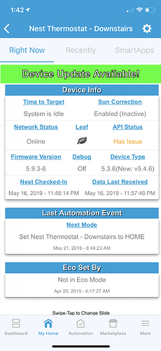

So you likely want to go into the ST mobile app and check if the NST devices are working in NST manager (ie you can see the devices, they update if you change temps manually at thermostat, and that they device handlers in ST can change the temperatures).
NST manager has setting to enable logging, etc.
The control within SmartThings is fairly unresponsive and freezes. Twice it kicked on the AC to the thermostat at 58 degrees despite the app not responding to my touch controls.
Adjusting the thermostat thru the nest app worked. Polling is at set at 3 minutes and doesn’t refresh by dragging the screen down like a light status might. I have to wait the full 3 minutes.
Despite the app being up to date (via community installer) it says there’s is a device update available and an API Status? issue.
You likely want to start checking out these issues (in your screen shot API Status).

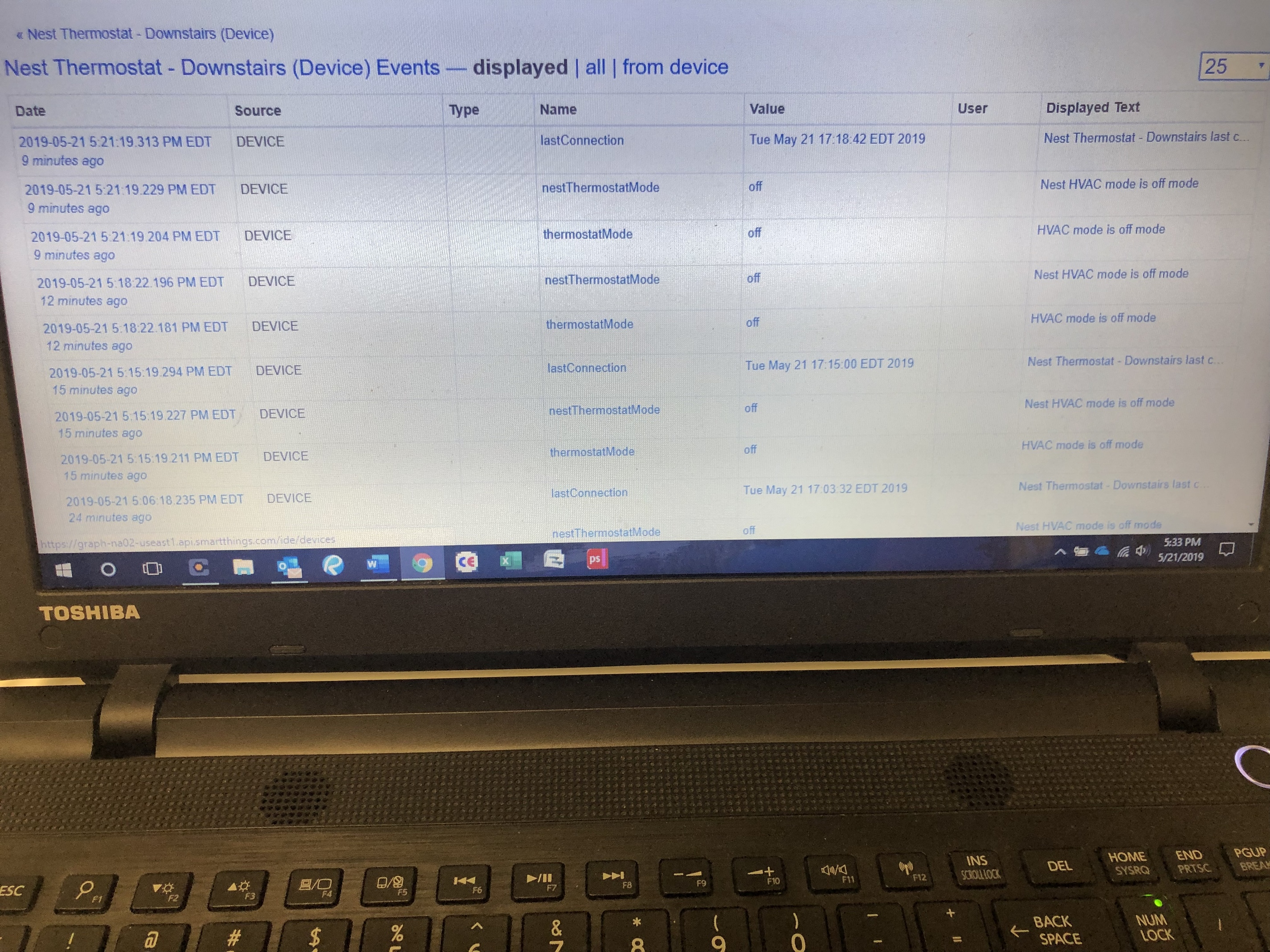

You can look at “Live Logging” in the IDE, and if needed enable more logging in NST manager.
KI went to live logging and it was empty.
Checking again, live logging says to click on the device and then events. I am looking at the events but I’m not sure what to do with this information.
Here is a screenshot of the last several events:
