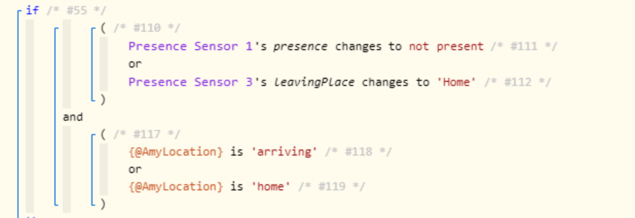

I am trying to set up an IF condition where IF the value of any two presence devices is “present” and AND the value of a variable is either “arriving” or “away” the IF is true then stuff happens which includes changing the tested variable to “home”. Changing the variable to “home” should make the IF condition return false anytime the presence devices change value until the variable is “away” or “arriving”

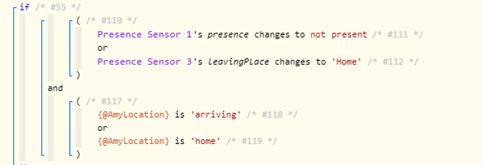

The IF is evaluating as TRUE when either presence device is present and seems to be independent of the variable. The IF that I am referring too is the second main IF that is based on two presence devices and a variable. It is IF #55. I am thinking it should read that the IF results in TRUE only when one of the presence devices is one of the values indicated AND when the variable is one of the value indicated. It seems the IF is not based on the two OR conditions together and analyses each OR condition on its own.
**4)
**5) Here is my Log. According to how the piston should work the execution at time 7:44 shows that the IF was tested as true and then the variable was set which should of set the variable to “away” which should then cause the same IF to result in a false outcome until the variable is set to “arriving” or “home”. However, at time 7:56 the IF condition is determine to be true and the piston runs and does the same steps again including setting the variable to “away” If I want the IF to be based on two OR conditions ANDed together do I need to imbed the one OR condition in from the other or can I have them on the same level like I do and am just setting it up wrong?

You have ‘arriving’ or ‘home’, not ‘arriving’ or ‘away’.
SMH…thanks. I just needed fresh eyes on it. Guess I was reading it as what I thought I wanted it to be instead of what I actually set it as…thanks.
Wait…I repsonded to quickly. Maybe I stated my issue wrong at the beginning. IF #55 statement should be true when based on two presence devices I leave home and the variable being “arriving” or “home”. This would equate to me leaving home or me entering the larger geofence and then leaving it without actually going home, hence the “arriving” value. The very next test in the piston that executes is to change the @AmyLocation variable to “away”. Though should result in the IF being false the next time either of the presence device go to indicated values since the part of the IF based on the @AmyLocation variable won’t be “arriving” or “home”…am I missing something?
