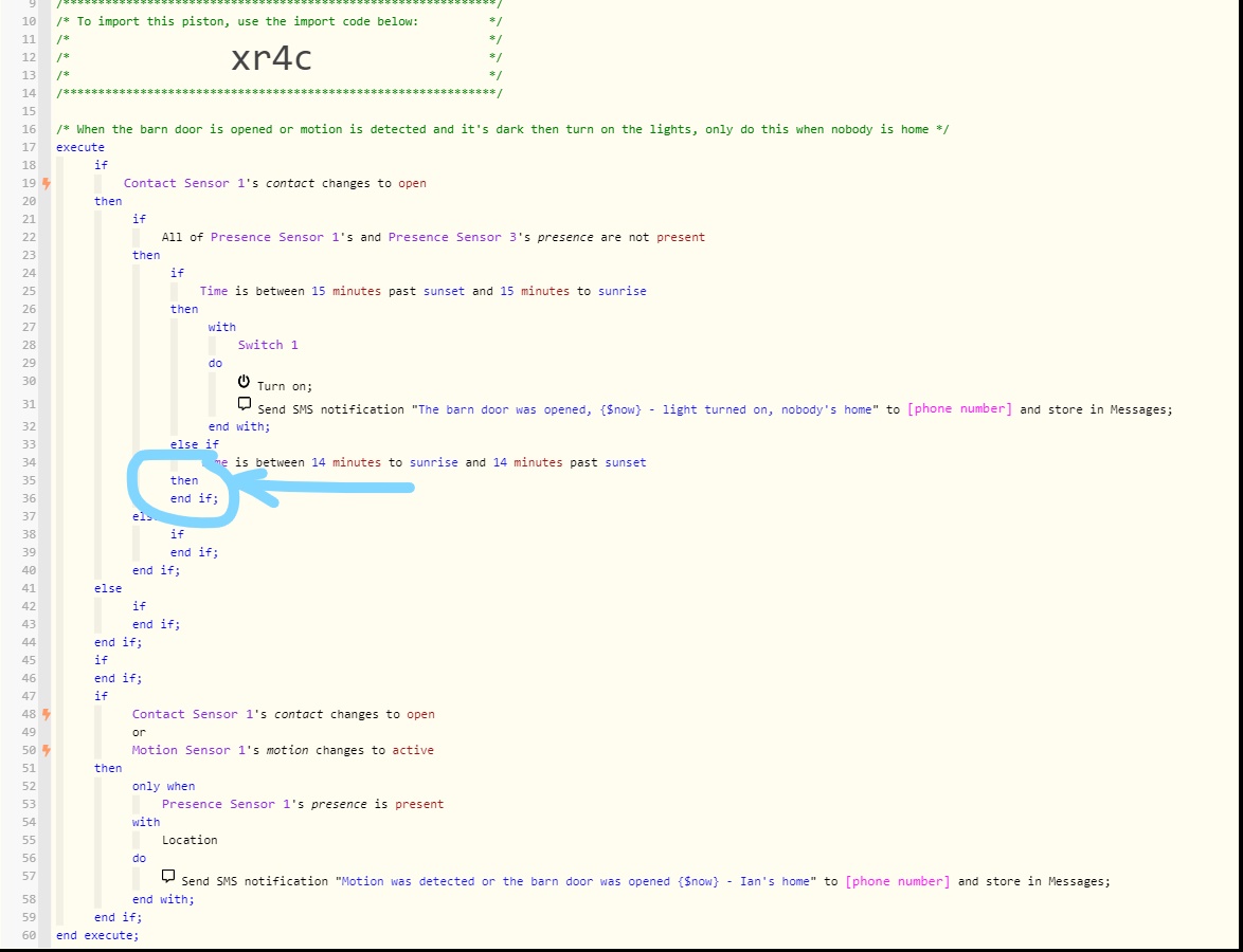

New statement -> Action, devices = Location is grayed out, can't add a task
I’m trying to add a new statement (as indicated in the image below), then action, devices = Location but when I drop down the list under devices I see location is grayed out; hovering the mouse over this shows a black stop icon.
I select Add Task but nothing happens.
I was hoping to be able to add a task
Nothing as indicated above.

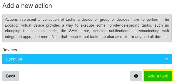

For generic commands, just ignore the drop down menu, and click in the lower right corner instead:
pic
Once you click “Add a task”, a new window will popup that allows for the specific task.
Alternatively, you can create the task in a new block elsewhere, and then drag & drop it in place.

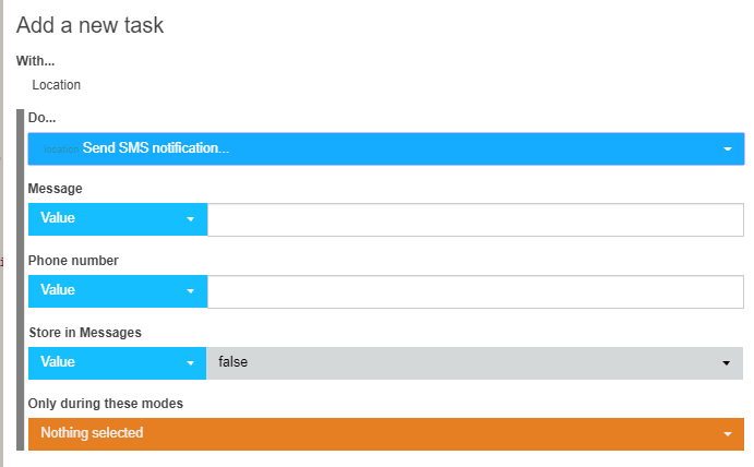

It got a little better, I can get to the add task interface but when I hit add it doesn’t add anything… So I have this:
But no code when I hit the add button. I’ll go with the workaround for now. It’s not as elegant imho!
