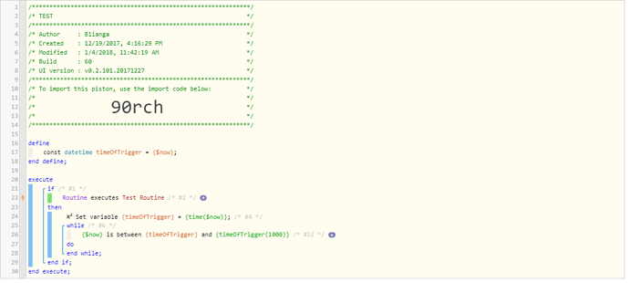

I am trying to do something pretty simple, which is when the virtual status changes from Away to Home, to start a timer. If while this timer has not expired and I open my door, the contact sensor will trigger enabling some lights. The problem I am having here is implementing a timer, the rest I can do. Here is some test code I generated to try and debug the issue I am having.
When running this routine, I come across this issue (bolded below):
1/4/2018, 11:42:31 AM +507ms
+0ms ╔Received event [Home].routineExecuted = acf79887-7969-4a6f-b97b-82b8c92afdb7 with a delay of 38ms
+73ms ║RunTime Analysis CS > 10ms > PS > 42ms > PE > 22ms > CE
+75ms ║Runtime (38190 bytes) successfully initialized in 42ms (v0.2.100.20171211) (74ms)
+76ms ║╔Execution stage started
+83ms ║║Comparison (string) :79a59b304b237699dd658e01dfd4bee9: executes (string) :79a59b304b237699dd658e01dfd4bee9: = true (2ms)
+84ms ║║Cancelling condition #2’s schedules…
+85ms ║║Condition #2 evaluated true (4ms)
+85ms ║║Cancelling condition #1’s schedules…
+86ms ║║Condition group #1 evaluated true (state changed) (6ms)
+88ms ║║Cancelling statement #3’s schedules…
+93ms ║║Executed virtual command setVariable (1ms)
+100ms ║║Calculating (datetime) 1515094951597 + (integer) 1000 >> (datetime) 1515094952597
+103ms ║║Comparison (datetime) 1515094951603 is_between (datetime) 1515094951597 … (datetime) 1515094952597 = false (2ms)
+104ms ║║Condition #12 evaluated false (9ms)
+105ms ║║Condition group #6 evaluated false (state did not change) (10ms)
+107ms ║╚Execution stage complete. (31ms)
+108ms ╚Event processed successfully (108ms)
This is probably not the best way to generate a timer, or add time to an epoch time, but I honestly don’t know how else to do it. Any guidance here is appreciated. The real issue is the comparison false when …1603 is clearly between …1597 and …2597, so this method wont work. Any and all help is appreciated here!! Thanks!!!
Probably doesn’t matter, but noticed that the const is not also set as time($now). The between evaluation being false is interesting — same behavior with an IF statement right?

If mode changes to home
Followed by
Contact sensor changes to open within xx time
Turn on some lights
End if
To create the above in webcore you need to add the two statements like above. Make sure they are in this order. When you add these they will default with and between them. Click on and and change it to followed by. After saving that you can now edit your second statement to make changes to the amount of time for it to happen.
Alternatively what @kevireilly suggested could also be made to work with some finesse but the followed by statement was made for this use case.
