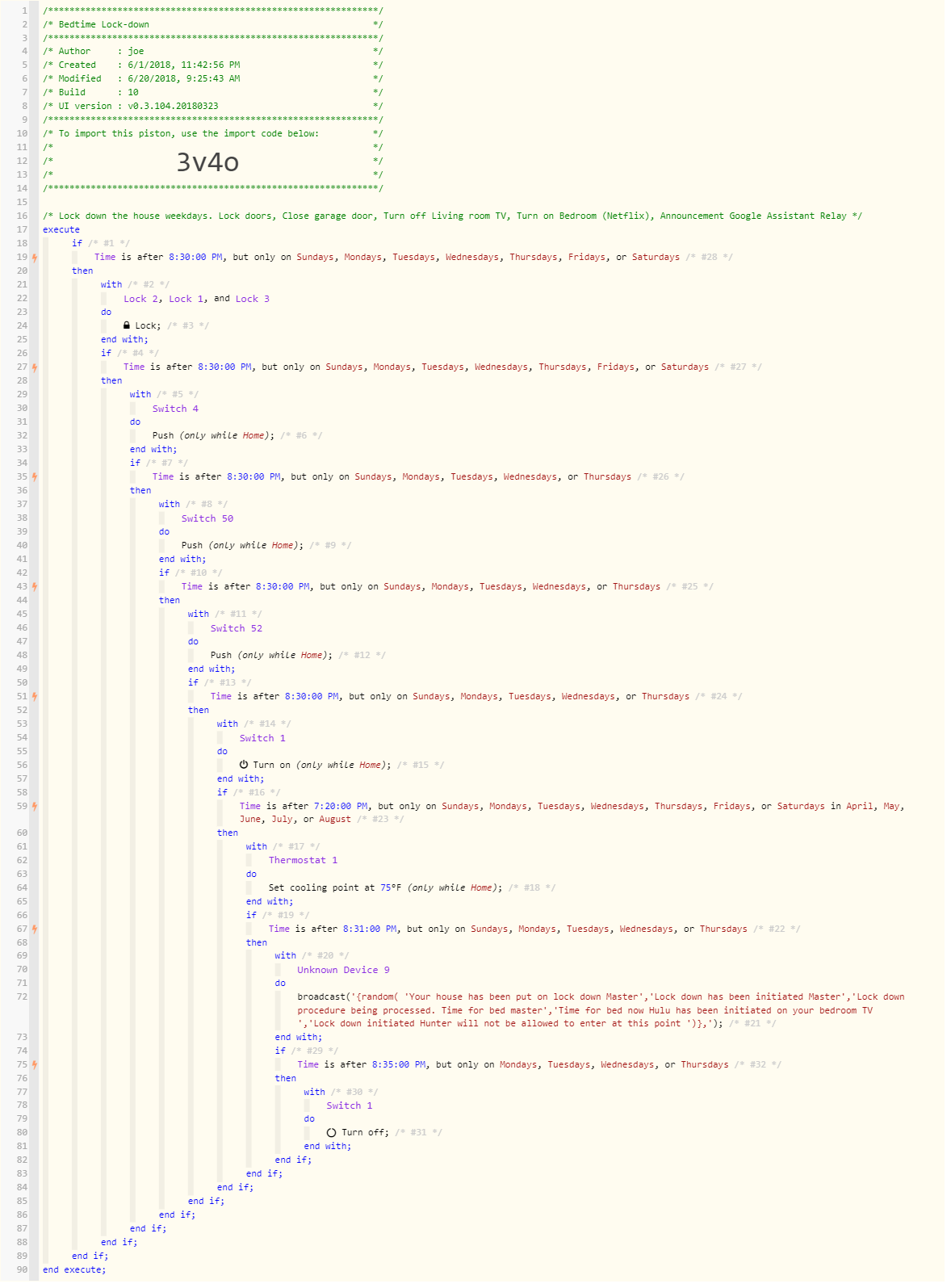

I have a piston setup to lock down the house at a certain time it works but not all aspects works as desired.
Lock all doors (Which happens) Shut garage door (Works), Turn off living room TV (Works sort of the way I want if you turn the TV back on it keeps turning it off until 8:35) Turn on bedroom TV (Works but shuts it back off at 8:35 when I would like the bedroom light to turn off which works)
Living room TV keeps shutting back off if turned on until 8:35) Bedroom TV turns back off at 8:35 which I would prefer to stay on)

+242ms â•‘â•‘Condition group #4 evaluated true (state did not change) (14ms)
+244ms ║║Cancelling statement #5’s schedules…
+352ms â•‘â•‘Executed physical command [Garage Door Close].push() (105ms)
+353ms â•‘â•‘Executed [Garage Door Close].push (107ms)
+362ms â•‘â•‘Comparison (time) 73859512 is_after (time) 73800000 = true (4ms)
+363ms â•‘â•‘Time restriction check passed
+364ms â•‘â•‘Condition #26 evaluated true (9ms)
+365ms ║║Cancelling statement #26’s schedules…
+368ms â•‘â•‘Requesting time schedule wake up at Wed, Jun 20 2018 @ 12:00:00 AM EDT
+370ms â•‘â•‘Condition group #7 evaluated true (state did not change) (15ms)
+372ms ║║Cancelling statement #8’s schedules…
+464ms â•‘â•‘Executed physical command [Roku: Power Off - LR].push() (88ms)
+465ms â•‘â•‘Executed [Roku: Power Off - LR].push (89ms)
+473ms â•‘â•‘Comparison (time) 73859624 is_after (time) 73800000 = true (4ms)
+474ms â•‘â•‘Time restriction check passed
+476ms â•‘â•‘Condition #25 evaluated true (8ms)
+477ms ║║Cancelling statement #25’s schedules…
+480ms â•‘â•‘Requesting time schedule wake up at Wed, Jun 20 2018 @ 12:00:00 AM EDT
+482ms â•‘â•‘Condition group #10 evaluated true (state did not change) (15ms)
+484ms ║║Cancelling statement #11’s schedules…
+531ms â•‘â•‘Executed physical command [Roku: Power On - MBR].push() (44ms)
+531ms â•‘â•‘Executed [Roku: Power On - MBR].push (45ms)
+540ms â•‘â•‘Comparison (time) 73859690 is_after (time) 73800000 = true (4ms)
+541ms â•‘â•‘Time restriction check passed
+542ms â•‘â•‘Condition #24 evaluated true (8ms)
+543ms ║║Cancelling statement #24’s schedules…
+547ms â•‘â•‘Requesting time schedule wake up at Wed, Jun 20 2018 @ 12:00:00 AM EDT
+549ms â•‘â•‘Condition group #13 evaluated true (state did not change) (15ms)
+551ms ║║Cancelling statement #14’s schedules…
+556ms â•‘â•‘Skipped execution of physical command [Bedroom Wemo Light Switch].on([]) because it would make no change to the device. (3ms)
+557ms â•‘â•‘Executed [Bedroom Wemo Light Switch].on (4ms)
+566ms â•‘â•‘Comparison (time) 73859716 is_after (time) 69600000 = true (4ms)
+567ms â•‘â•‘Time restriction check passed
+568ms â•‘â•‘Condition #23 evaluated true (9ms)
+569ms ║║Cancelling statement #23’s schedules…
+572ms â•‘â•‘Requesting time schedule wake up at Wed, Jun 20 2018 @ 12:00:00 AM EDT
+574ms â•‘â•‘Condition group #16 evaluated true (state did not change) (15ms)
+576ms ║║Cancelling statement #17’s schedules…
+935ms â•‘â•‘Executed physical command [Nest Thermostat - Hallway].setCoolingSetpoint([75.0]) (352ms)
+936ms â•‘â•‘Executed [Nest Thermostat - Hallway].setCoolingSetpoint (354ms)
+945ms â•‘â•‘Comparison (time) 73860095 is_after (time) 73860000 = true (4ms)
+946ms â•‘â•‘Time restriction check passed
+947ms ║║Cancelling condition #22’s schedules…
+948ms â•‘â•‘Condition #22 evaluated true (9ms)
+952ms ║║Cancelling statement #22’s schedules…
+955ms â•‘â•‘Requesting time schedule wake up at Wed, Jun 20 2018 @ 12:00:00 AM EDT
+957ms ║║Cancelling condition #19’s schedules…
+958ms â•‘â•‘Condition group #19 evaluated true (state changed) (19ms)
+960ms ║║Cancelling statement #20’s schedules…
+967ms â•‘â•‘Calculating (string) Lock down has been initiated Master + (string) , >> (string) Lock down has been initiated Master,
+1371ms â•‘â•‘Executed physical command [Google Assistant Relay].broadcast([Lock down has been initiated Master,]) (400ms)
+1372ms â•‘â•‘Executed [Google Assistant Relay].broadcast (402ms)
+1384ms â•‘â•‘Comparison (time) 73860533 is_after (time) 74100000 = false (5ms)
+1385ms ║║Cancelling condition #32’s schedules…
+1386ms â•‘â•‘Condition #32 evaluated false (9ms)
+1388ms ║║Cancelling statement #32’s schedules…
+1392ms â•‘â•‘Requesting time schedule wake up at Tue, Jun 19 2018 @ 8:35:00 PM EDT
+1394ms ║║Cancelling condition #29’s schedules…
+1395ms â•‘â•‘Condition group #29 evaluated false (state changed) (19ms)
+1410ms ║╚Execution stage complete. (1230ms)
+1414ms â•‘Setting up scheduled job for Tue, Jun 19 2018 @ 8:35:00 PM EDT (in 239.431s), with 7 more jobs pending
+1467ms ╚Event processed successfully (1467ms)
6/19/2018, 8:29:59 PM +118ms
+0ms â•”Received event [Home].time = 1529454600000 with a delay of -883ms
+169ms â•‘RunTime Analysis CS > 17ms > PS > 56ms > PE > 97ms > CE
+172ms â•‘Runtime (43131 bytes) successfully initialized in 56ms (v0.3.104.20180323) (171ms)
+174ms â•‘â•”Execution stage started
+191ms â•‘â•‘Comparison (time) 73799301 is_after (time) 73800000 = true (6ms)
+193ms â•‘â•‘Time restriction check passed
+194ms ║║Cancelling condition #28’s schedules…
+195ms â•‘â•‘Condition #28 evaluated true (13ms)
+196ms ║║Cancelling statement #28’s schedules…
+200ms â•‘â•‘Requesting time schedule wake up at Wed, Jun 20 2018 @ 12:00:00 AM EDT
+203ms ║║Cancelling condition #1’s schedules…
+204ms â•‘â•‘Condition group #1 evaluated true (state changed) (21ms)
+206ms ║║Cancelling statement #2’s schedules…
+212ms â•‘â•‘Skipped execution of physical command [Backdoor].lock([]) because it would make no change to the device. (3ms)
+213ms â•‘â•‘Executed [Backdoor].lock (4ms)
+218ms â•‘â•‘Skipped execution of physical command [Front Door Lock].lock([]) because it would make no change to the device. (2ms)
+219ms â•‘â•‘Executed [Front Door Lock].lock (4ms)
+242ms â•‘â•‘Executed physical command [Kichen French Door].lock() (20ms)
+243ms â•‘â•‘Executed [Kichen French Door].lock (21ms)
+253ms â•‘â•‘Comparison (time) 73799364 is_after (time) 73800000 = true (4ms)
+254ms â•‘â•‘Time restriction check passed
+255ms â•‘â•‘Condition #27 evaluated true (9ms)
+257ms ║║Cancelling statement #27’s schedules…
+261ms â•‘â•‘Requesting time schedule wake up at Wed, Jun 20 2018 @ 12:00:00 AM EDT
+264ms â•‘â•‘Condition group #4 evaluated true (state did not change) (19ms)
+267ms ║║Cancelling statement #5’s schedules…
+346ms â•‘â•‘Executed physical command [Garage Door Close].push() (76ms)
+347ms â•‘â•‘Executed [Garage Door Close].push (77ms)
+357ms â•‘â•‘Comparison (time) 73799468 is_after (time) 73800000 = true (5ms)
+358ms â•‘â•‘Time restriction check passed
+359ms â•‘â•‘Condition #26 evaluated true (9ms)
+360ms ║║Cancelling statement #26’s schedules…
+364ms â•‘â•‘Requesting time schedule wake up at Wed, Jun 20 2018 @ 12:00:00 AM EDT
+367ms â•‘â•‘Condition group #7 evaluated true (state did not change) (17ms)
+369ms ║║Cancelling statement #8’s schedules…
+581ms â•‘â•‘Executed physical command [Roku: Power Off - LR].push() (208ms)
+582ms â•‘â•‘Executed [Roku: Power Off - LR].push (211ms)
+599ms â•‘â•‘Comparison (time) 73799706 is_after (time) 73800000 = true (8ms)
+601ms â•‘â•‘Time restriction check passed
+603ms â•‘â•‘Condition #25 evaluated true (15ms)
+605ms ║║Cancelling statement #25’s schedules…
+611ms â•‘â•‘Requesting time schedule wake up at Wed, Jun 20 2018 @ 12:00:00 AM EDT
+615ms â•‘â•‘Condition group #10 evaluated true (state did not change) (27ms)
+617ms ║║Cancelling statement #11’s schedules…
+652ms â•‘â•‘Executed physical command [Roku: Power On - MBR].push() (33ms)
+653ms â•‘â•‘Executed [Roku: Power On - MBR].push (34ms)
+663ms â•‘â•‘Comparison (time) 73799775 is_after (time) 73800000 = true (5ms)
+664ms â•‘â•‘Time restriction check passed
+665ms â•‘â•‘Condition #24 evaluated true (9ms)
+667ms ║║Cancelling statement #24’s schedules…
+670ms â•‘â•‘Requesting time schedule wake up at Wed, Jun 20 2018 @ 12:00:00 AM EDT
+673ms â•‘â•‘Condition group #13 evaluated true (state did not change) (17ms)
+675ms ║║Cancelling statement #14’s schedules…
+699ms â•‘â•‘Executed physical command [Bedroom Wemo Light Switch].on() (20ms)
+700ms â•‘â•‘Executed [Bedroom Wemo Light Switch].on (22ms)
+711ms â•‘â•‘Comparison (time) 73799821 is_after (time) 69600000 = true (6ms)
+712ms â•‘â•‘Time restriction check passed
+714ms â•‘â•‘Condition #23 evaluated true (10ms)
+715ms ║║Cancelling statement #23’s schedules…
+719ms â•‘â•‘Requesting time schedule wake up at Wed, Jun 20 2018 @ 12:00:00 AM EDT
+721ms â•‘â•‘Condition group #16 evaluated true (state did not change) (19ms)
+724ms ║║Cancelling statement #17’s schedules…
+1088ms â•‘â•‘Executed physical command [Nest Thermostat - Hallway].setCoolingSetpoint([75.0]) (359ms)
+1090ms â•‘â•‘Executed [Nest Thermostat - Hallway].setCoolingSetpoint (360ms)
+1107ms â•‘â•‘Comparison (time) 73800214 is_after (time) 73860000 = false (8ms)
+1109ms ║║Cancelling condition #22’s schedules…
+1110ms â•‘â•‘Condition #22 evaluated false (13ms)
+1114ms ║║Cancelling statement #22’s schedules…
+1118ms â•‘â•‘Requesting time schedule wake up at Tue, Jun 19 2018 @ 8:31:00 PM EDT
+1122ms ║║Cancelling condition #19’s schedules…
+1123ms â•‘â•‘Condition group #19 evaluated false (state changed) (27ms)
+1133ms ║╚Execution stage complete. (960ms)
+1137ms â•‘Setting up scheduled job for Tue, Jun 19 2018 @ 8:31:00 PM EDT (in 59.746s), with 6 more jobs pending
+1144ms ╚Event processed successfully (1144ms))
