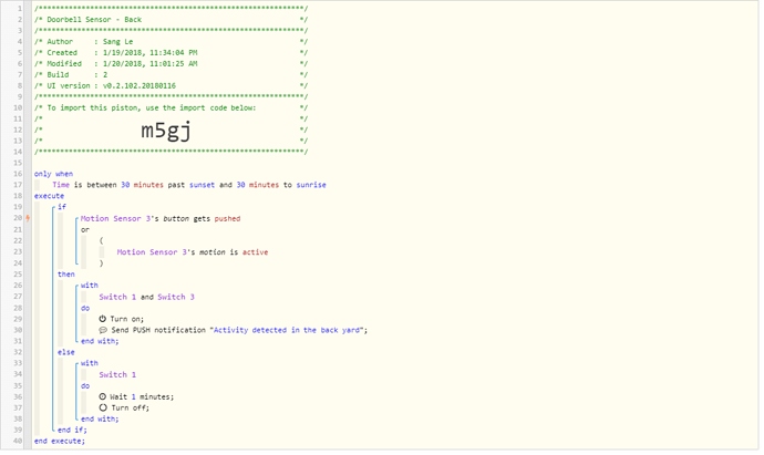

Please post a green snapshot of your problem piston.
Ok, what I’ve done is a simple motion sensor which turn on the lights and if no motion in 1 min, light turns off. I am using the Ring door sensor and TP-Link light switch. It’s running fine when I have my PC but as soon as it turns off, nothings happen.

Your piston looks fine.
The false will be displayed when piston conditions are false (so outside time of day or motion inactive)
