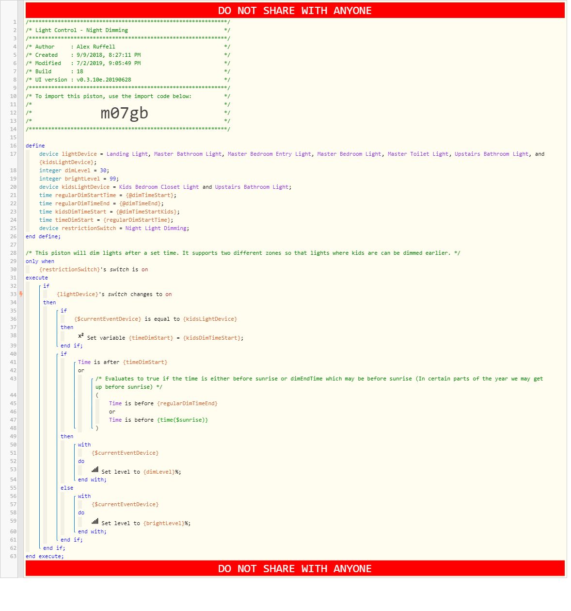

Night Dimming of lights with 2 different start times depending on the device triggered
As soon as I added a second device in kidsLightDevice, the IF statement will no longer ever evaluate to TRUE. I can’t figure out how to have the IF evaluate to TRUE if any of the devices in kidsLightDevice match $currentEventDevice
If any of the devices in kidsLightDevice match the $currentEventDevice, the earlier start time for the dimming is set
The earlier dim time is never set as soon as I add more than one device in kidsLightDevice

NOTE: Yes, I know that the LOGS are not for the event where a device in the kidsLightDevice was activated but the kids are sleeping and I can’t trigger it now. Either way, this piston was working until I added two device in kidsLightDevice so I am quite sure it is not working due to a bad condition. I am also quite sure that my code is awful so any improvements are quite welcome!! :slight_smile:
Try it as an expression…
contains(kidsLightDevice,$currentEventDevice) is true
It fixed the issue, thank you!
Any reason why there isn’t an option to do it without using an expression?
No idea, sorry lol. I thought maybe it should have presented a comparison of $currentEventDevice is any of deviceVariable as an option at least.
