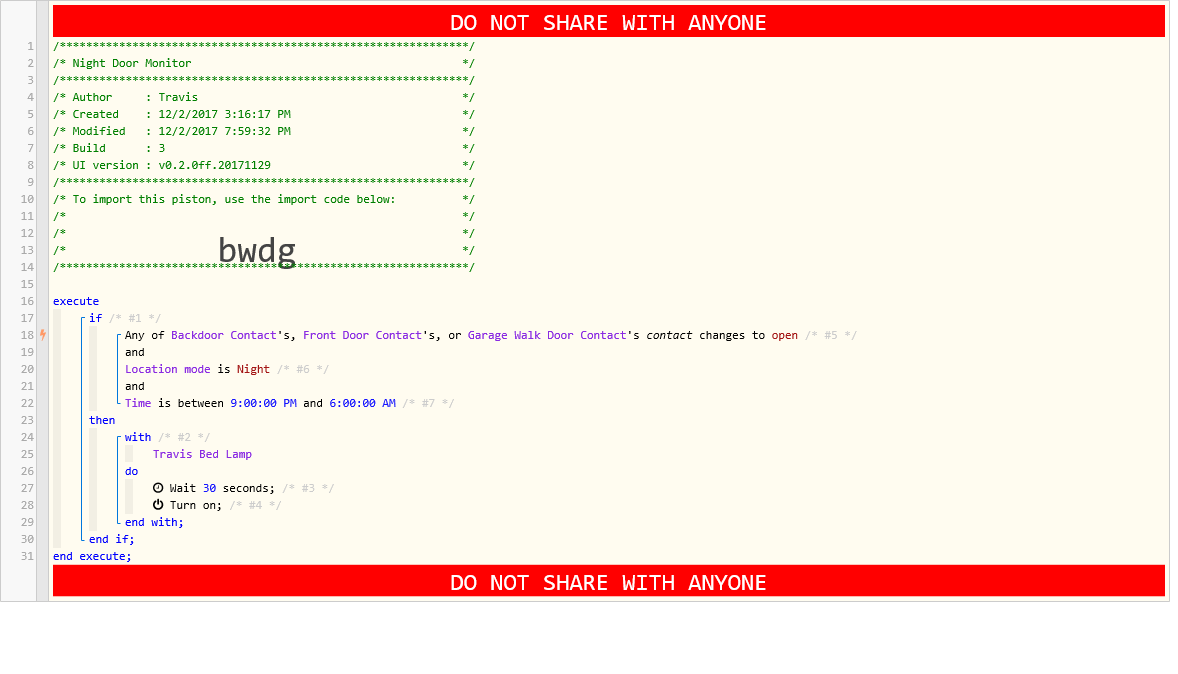

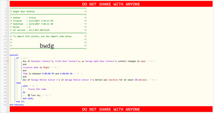

I would like to be able to monitor doors at night time in case my kids sleep walk and try to go outside.
I would like to turn on a lamp if they open the door between certain hours alerting my wife and I.
Everything works fine except I want to be able to somehow disable it for a short time incase the wife or myself are out late and come home during the hours the doors are monitored. I don’t want the lamp coming on if one of us comes home and the other is sleeping. I really don’t want to use a presence sensor but will if I have to.
I have a contact sensor on the garage door and could use that to either pause a piston or create a variable. I’m just wondering what would be the best way to go about it disabling the lamp from turning on for say 30-1 min if one of us comes home late?
