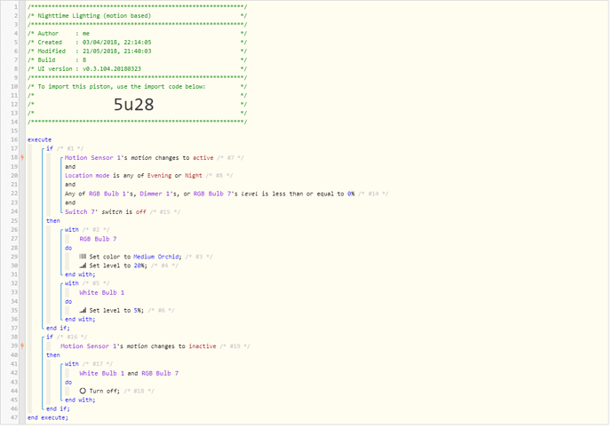

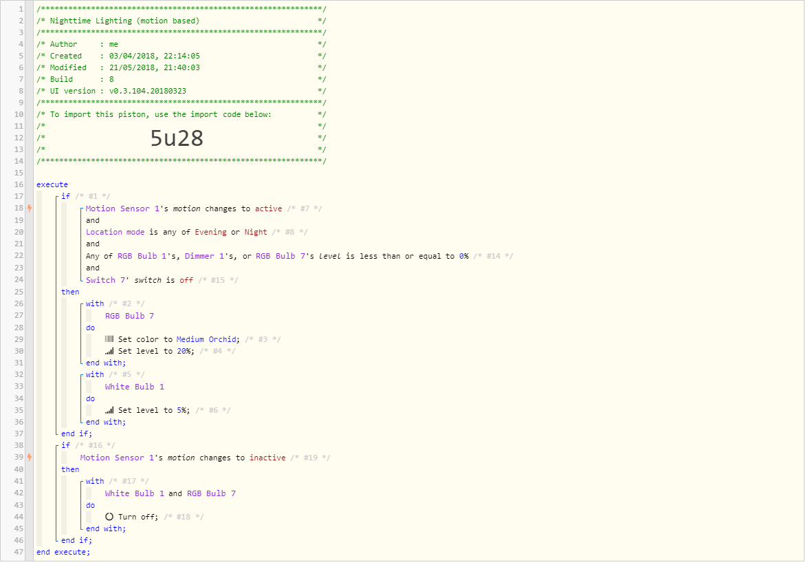

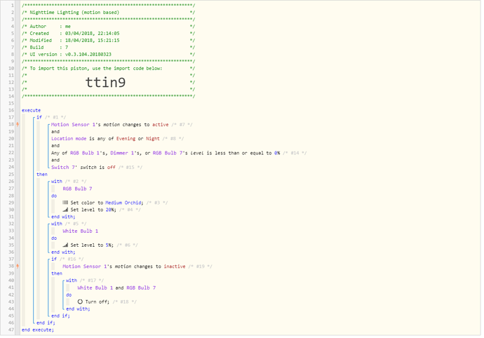

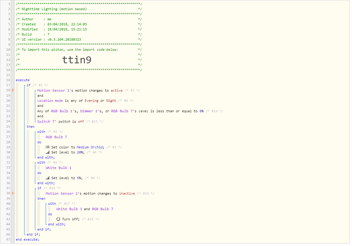

Looking for a motion based nightlight solution
motion trigger will turn on 2 lights and if after x period of time there is no motion, turn the lights off again.
Seems to be turning on but not off… I would also like to include a second or third motion sensor for the off command if possible.
