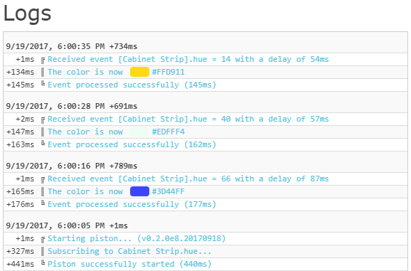

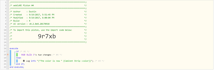

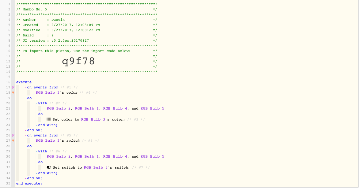

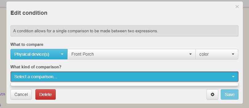

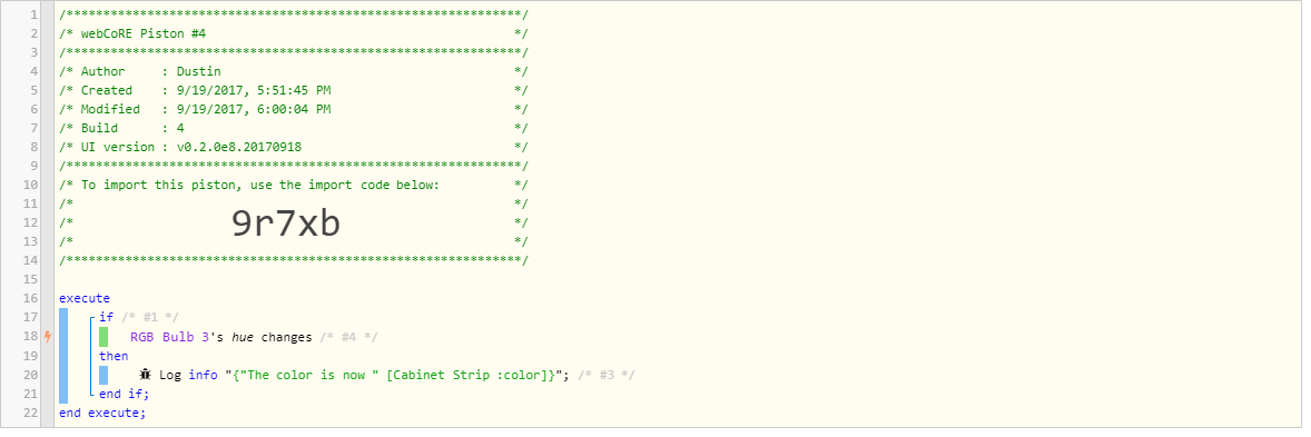

I’m trying to setup a piston that causes multiple physical RGB bulbs to follow the color of a single virtual RGB bulb by running the piston when the virtual bulb’s color changes. When selecting the virtual RGB bulb (or any of my physical bulbs for that matter) for the condition, I can select color as the value to look at but there are no comparison options to choose from. If I choose any other value (i.e. color temperature, level, etc.) I can choose from all of the comparison options. I’m not sure if there is something I’ve missed or whether it is a bug in the smart app.
Having a list of evaluations to choose from when selecting the color of an RGB bulb (in this case, whether it changes).
See (1).
Thanks in advance for any assistance. I’m not super proficient yet with setting up webCoRE rules so it’s possible this could be a me problem.
