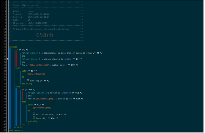

If condition is not met anymore, wait doesn’t reset, scheduling is not canceled
If the temperaure setpoint is sucessfully changed on first try, scheduling should be canceled
Very short on the intended function: My thermostat is naughty, doesn’t like to receive commands sometimes so in order to make sure the heating setpoint is changed, after first command, wait for 60s, send PUSH notification and try again, for 3 times. 2 set of comands each day.
No matter if setpoint chage was succesful after first, second or third try … the code will execute no matter the conditions and all 3 PUSH notifications will be received.
TCP set to on condition state. Why is scheduling after 60s not canceled if the condition is not fulfilled anymore? Could be because of every (TOD) triggers?
I can solve this on many different ways but I’m scratching my head over why this doesn’t work.
