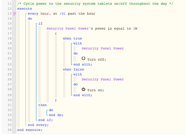

First time with webCoRE and having issues connecting the dots… hoping someone can help as this seems like simple stuff that I’m just not getting.
(1) I see example pistons using the “Log to console” action… how are you getting this into the piston?
(2) I have a standard SmartThings plug that cycles power on / off to devices (called “Security Panel Power” in the screenshot below). What’s the correct way to test the on/off state of this device? I’ve tried the “power” & “$status” options, but can’t seem to test it correctly…

When you log to console, try using Expression, then you can query the device attributes in the format [DeviceName:attribute] in your case you want [Security Panel Power:switch]

HOW do you log to the console? I select “Add a new statement” within a DO block and there’s no option to log. When I select ACTION, there’s no option…
Add a DO block, Add a Statement, Add an Action, Select a Device (Location is default if you just want to do something), then Add a Task, then Log to Console.
THAT helps… thanks!
