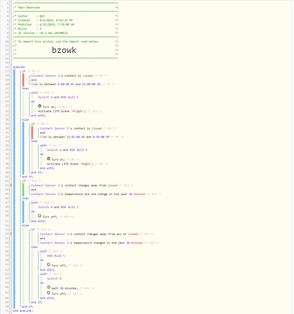

I have a piston for the bathroom that should activate 1 of 2 Lifx scenes. It seems to turn on the Lifx lights but defaults to the last scene it was on rather than the correct scene.
When I close, the door, the lights turn on and based on the time of day, should activate either bright (daytime) or night (nighttime).
The lights turn on to the last state they were in. Not either scene.

I am using webcore. It’s not activating the correct scene in the webcore code (see attached pic of the code). Lifex is a smart light brand.
Thanks, Lisa
Let me try to understand your piston…
What is line 26 is doing?
What is it activating?
And also line 38?
I wonder if the turn on is needed when activating a lifx scene. If it is needed, try adding a Wait 1 second between the turn on and activate scene.
