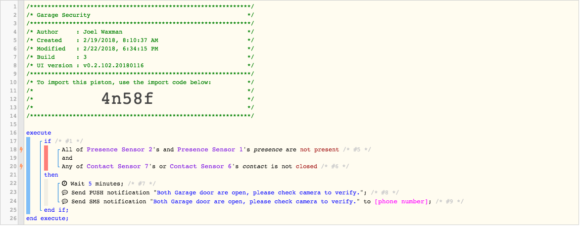

Maybe you are right, then do you think this piston will work to warn us? The delay is important do to the Geographic circle.
I dont think you need the delay … If I think this through I get in the car and start driving - the pres sensor will say I am away - and without the delay it will imeediately notify me (which is what I would want…)

if All of Presence Sensors STAYS AWAY FROM PRESENT for 3 Minutes
and
ALL Doors are OPEN
If I am on the ball that will also help the fluctuation and weird behaviors of the Presnece sensors from time to time…

OK the reason for the delay is that my Geo fence overlaps in a place where when I exit my development and make a right I have to jug-handle around crossing the same geo fence. Here in New Jersey we have Jug-Handles, which are turns only from the right. So timer is necessary. My Piston will it work?
Yes but the problem is I built my own garage door openers using a Inovelli Dual Channel smart plug and two relays. It works perfectly every time including using Alexa. So if I have a plug in line and it turns off, I will be nagged with Offline alerts for the Inovelli.
Yeah – should work :slight_smile:
And I work in NJ (Live in NEPA) so understand the jug handle conundrum all too well :frowning:
Yea this jug-handle plays tricks with my presence, first I am away, then when I cross in front of my development, I am back then away again in a few hundred feet. That is why I thought the dealy would help.
