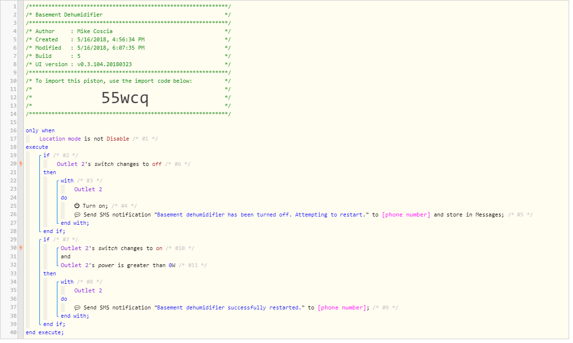

Not receiving SMS Messages
Not receiving SMS messages in a newly created piston.
I should receive an SMS message when my dehumidifier is turned off, then another one when it is turned on.
The piston successfully turns on the dehumidifier back on after being off, but I do not receive an SMS notification.

Is your location in the U.S. or other country? If you are in the U.S., did you enter 10 digits with no other characters?
Yeah, I am in the US and entered as 1-XXX-XXXX.
edited Sorry, typed that wrong. The number is correctly entered in the piston with area code… 1-XXX-XXX-XXXX. That was my goof when responding to the question.
I just enter my 10 digit phone number without the country code and without the dashes
Try putting a + in front of the 1.
The number needs to be in E164 format for it to work for me in the UK.
e.g. +44 7777 123 456.
In the U.S., it is not necessary to add the country code (+1) :slight_smile:
Are you missing the area code?
Oh sorry, that was a typo. Yeah, I have the area code in… 1-XXX-XXX-XXXX. I’ll try adding the + and see if it goes through.
I figured as much but just thought I’d ask.
I’d try it liek @jkp suggested. Just the 10 digits with no dashes or a plus up front.
So it the first text randomly started working. Although, I always do not get the second text. Wonder if something is up with SmartThings. I’ll keep testing it out.
