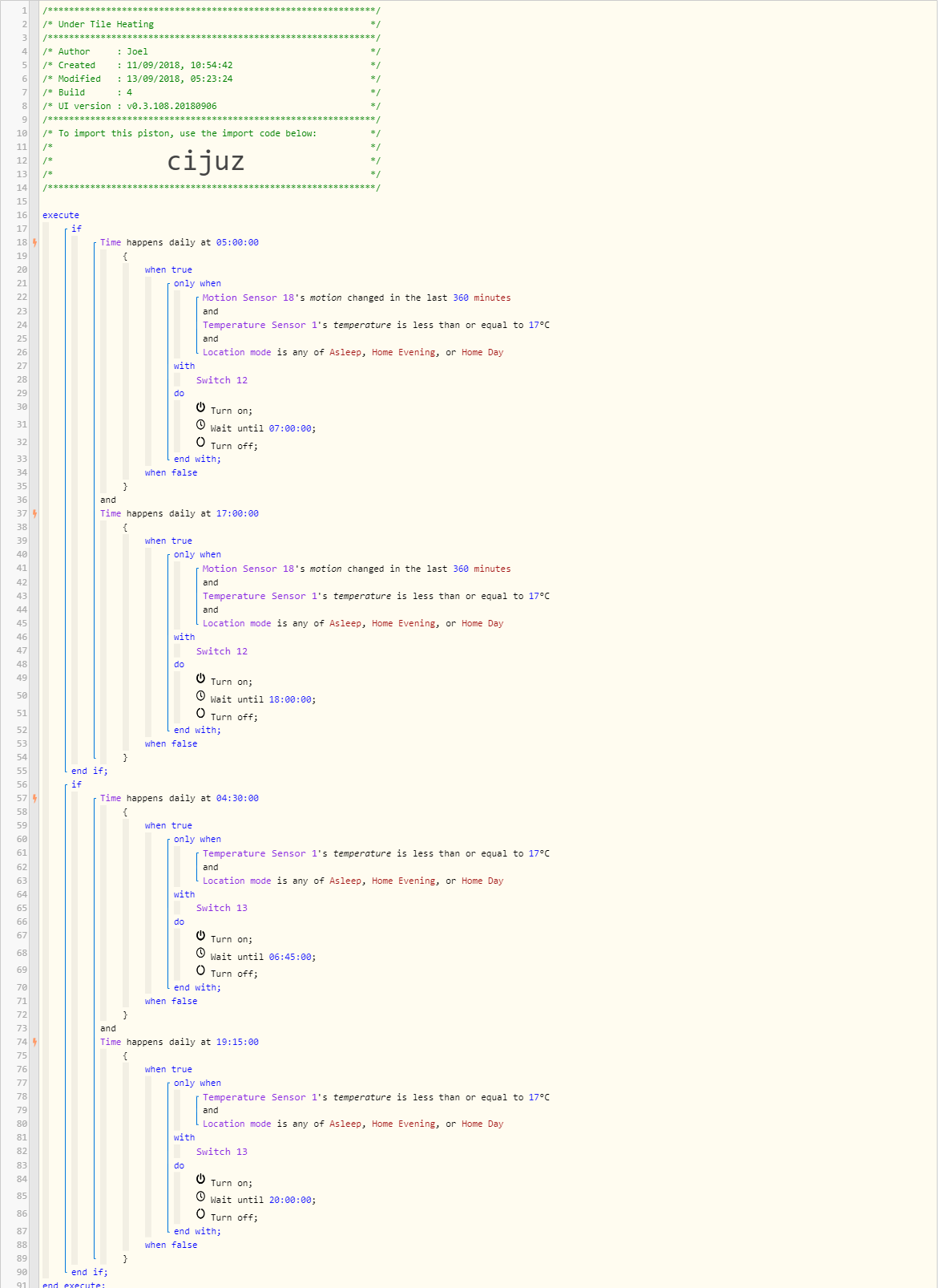

Piston says it is not subscribed to events bit has lighting in sides next to time triggers.
It is not firing though
Piston should fire at times and turn on switch if another switch is on.
Piston is not firing at all

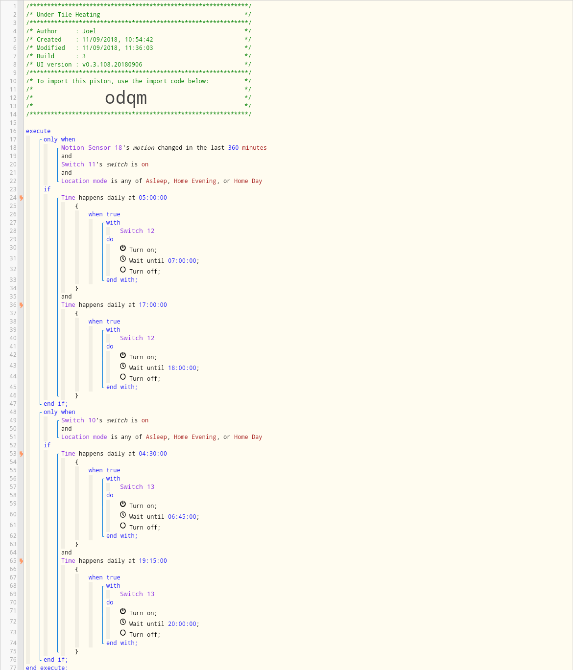

how does this look?
kind of seems redundant to have the restrictions entered twice on each IF. but if it works i’m happy!
I am not at a computer at the moment, but I do notice one thing. Where I suggested to use an IF, you didn’t. And where I did not use an IF, you did.
With your current wording, it should do absolutely nothing.
(it is impossible for the time to be 5am and 5pm simultaneously)
My free time today is limited, but if you can wait until tomorrow, I can whip up a piston for you that should work as expected.
goodness me. you’re right. can’t believe i missed that.
not sure how I can bring them up higher. tomorrow is fine - you’re helping me out! :slight_smile:

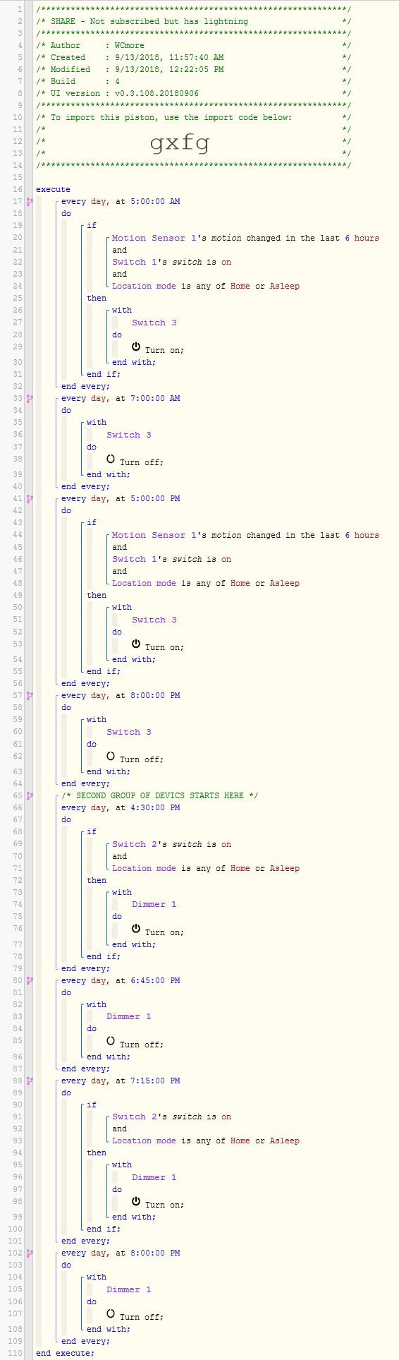

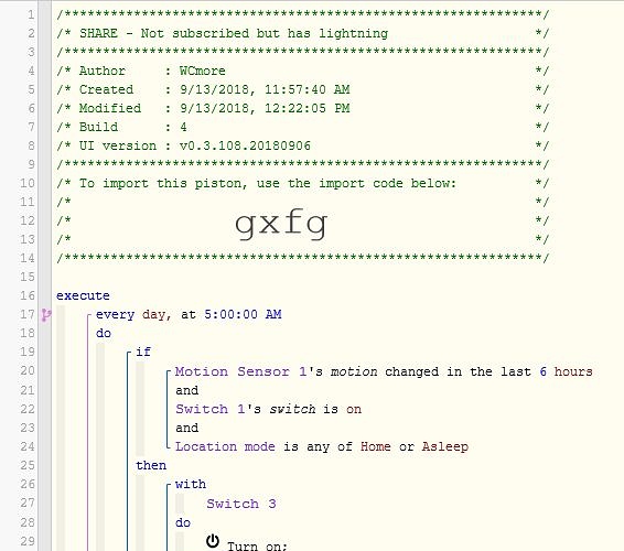

I have re-worked the structure in your piston to streamline it.
With this method, the piston will ONLY run 8 times a say, at the times listed. If one of the conditions is not true at the time, it skips that group of commands.
Be careful when importing this piston (gxfg)
temp
because there are 5 devices that need to go in the right section.
(you can use your old piston for reference)
If you are new to webCoRE, make sure you PAUSE your old piston to properly test this one.
(so they don’t conflict)
