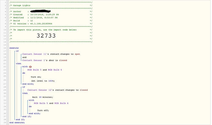

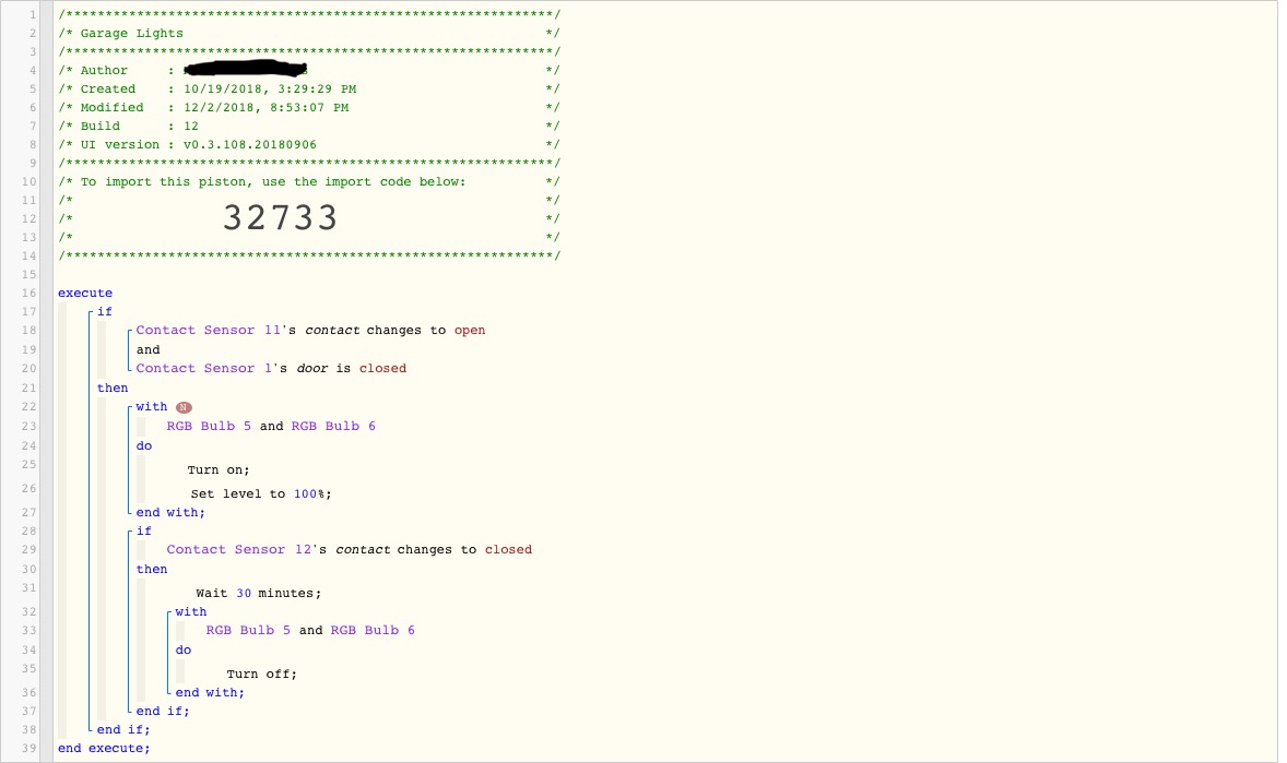

I created the piston for the lights in my garage. Basically I want the lights to come on when the door is opened. Sometimes if I am working or hanging out in the garage, I will leave the door open. So when I close the door, I want the lights to turn off 30 min after the door is closed.
The lights are not turning off. I have a feeling it has to do with an incorrect setup of the second part. I am guessing WebCoRE sees the first event, but then stops and never knows to look for the second event as it could be at random times.

Just change TASK CANCELATION POLICY to NEVER CANCEL TASKS
that means, even if the piston’s current job is done JUST WAIT until everything is done…
let me change your piston a bit and re-post it.
Edit : I just saw you already used never cancel task in part one, so you know how it’s done.
note : I would just change the design a bit for the second part,

Awesome! I changed the task cancellation policy right before I posted it. I will make the other adjustments.
With this set up, if I open the door, then close it and open and close again (let’s say I am taking the trash out and don’t want the dog in the garage), well those actions repeatedly rest the timer?
