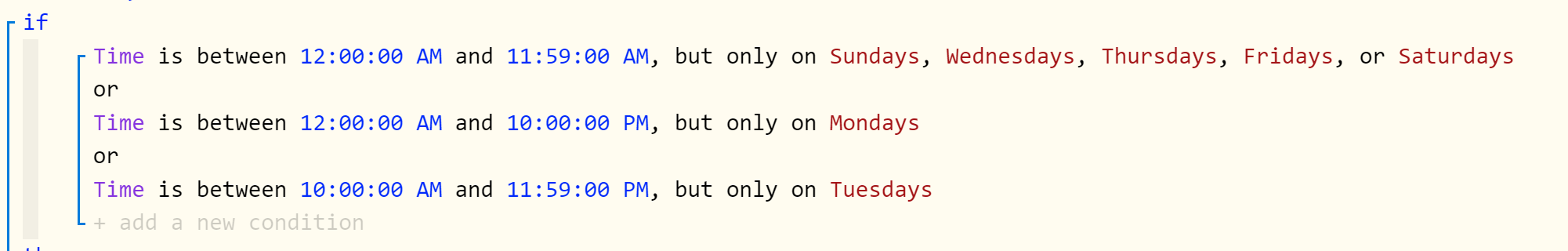

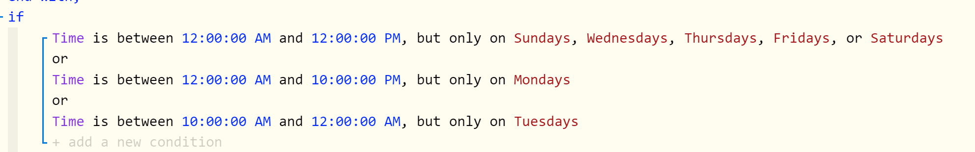

I’ll try this, what do you think?
himmmm interesting…
On the paper it should work…
Sometimes i had a problem with TIME (don’t know why) but webcore has an interesting aproach to between X time and Y time…
the best would be to test it…
But with my limited knowledge, it looks like it should work…
Anyone???
edit : Just to be safe, use 12:01:00 for am times. I don’t know IF 12:00:00 am is considered MONDAY or still SUNDAY midnight???

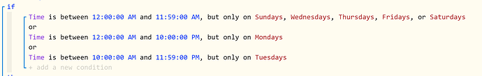

12:00 AM is by standard the start of the day. Maybe in the “tuesdays” setting I should set it to 11:59PM.
EDIT: Also for every other day of the week.
Sounds great…
my only concern is the first one
I am not sure if webcore sees that as 24 hours (or 23:59 hours) in logic??? it might even see that as a minute??? or zero minutes in the other way you did.
