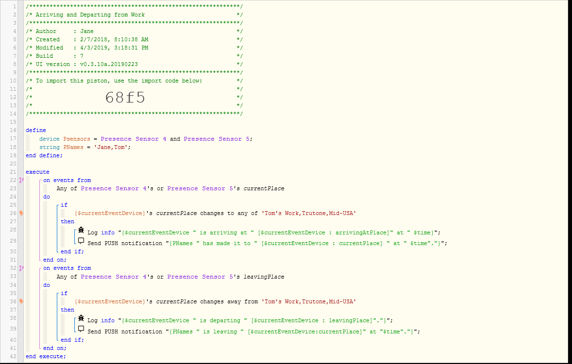

I would like to have a push notification when a presence sensor arrives or departs from a WC location. Since I have ST and WC presence sensors, they are named funny and I would like to have the actual name on the notification. IE: presence sensors are named Jane-WC and Tom-WC but I would like the notification to say Jane has left location or Tom has left location.
I am not sure if this piston will actually work as it is right now. But I need some help also with defining the names to be normal.

you can write this piston with two seperate IF blocks instead of “any presence sensor”
I haven’t tested but if I’m not mistaken, currently, your Pnames variable will write Jane,Tom in both cases because you are not recording anything into the variable inside the piston.
Try this: (just a draft)
IF Presense sensor location changes to any of “TOM’s work, Trudence,Mid-Usa”
Save matching devices
Send PUSH notification "Tom has left {location} at {time}
If there are common characters in the sensor names, you can just use the replace() function.
replace($currentEventDevice,"-WC","")
In your example above, it will drop all -WC from the sensor names and give you Tom or Jane.
This seems like an easier way to do it if I change the names to all have -WC. Where do I put the replace function?
You can put that in your notification or logging, use an Expression box and substitute that anywhere you use $currentEventDevice
So like this?
replace($currentEventDevice,"-WC","") " has made it to " [$currentEventDevice : currentPlace] " at " $time"."
Yup
Thanks! This worked!
