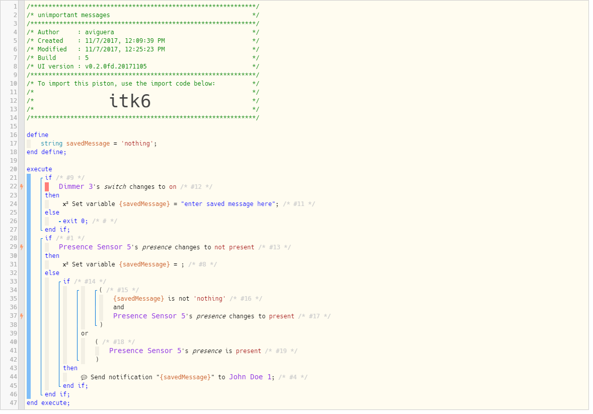

To clarify further, what I’m hoping to accomplish is something like this:
If virtual switch turns on and presence sensor is present, send message immediately.
If virtual switch turns on and presence sensor isn’t present, send message when presence sensor arrives.
The virtual switch is a momentary switch that gets turned on by IFTTT when my wemo humidifier runs out of water.
Yeah I think what you want to do is pretty clear… I was thinking of implementing something similar but more to use as a sort of framework to relay “reminders” or things that don’t need immediate attention, but that eventually I’d want to get to anyway… :slight_smile:
I think if you use something like this, with some tweaks, it should work…
Basically if the switch changes, then set the variable to hold the message (in your case “humidifier is out of water” or whatever).
Then you check the presence sensor… if the message is not blank and you arrive, or you’re already present, then send the message as a notification. That means every time the switch changes you would be notified if you’re home, or when you arrive.
When you leave, the variable is “reset” so that it would only have the message if the switch changed while you were away.
At least I think that would work, but there are probably 100 ways to do this better :slight_smile:
