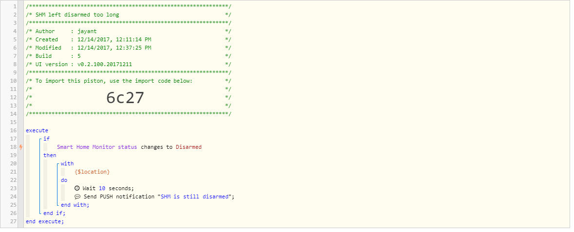

When SHM changes to Disarmed. After elapsed time (10 seconds in the example below), it should check if SHM is still disarmed and if not send a push notification reminder.
There is no way to add a wait statement inside the if block directly and there is not way to add if statement inside the with/do block. So I cannot ignore sending notification if the SHM was armed again before the elapsed time.

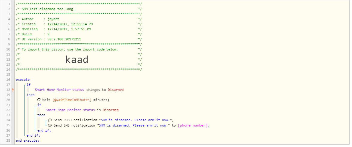

I was able to solve it using:
