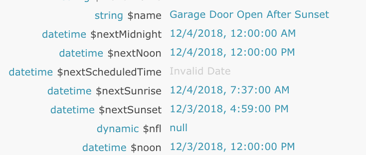

One question, however, I still see the variable $nextScheduledTime = Invalid Date. Is that a problem?
Not sure about that… open the piston and see if it updates.

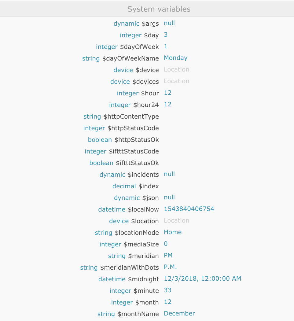

Well… It doesn’t seem to be updating, but it doesn’t seem to be affecting anything either. So I don’t know. I also notice that the $device and $devices variables are also grayed out and say “Location”, which looks similar to the $nextScheduledTime variable, is that normal?
Post a pic of where you’re seeing this… Monday morning, my brain functions are limited.
Mine shows the same thing, I’m guessing it’s normal
