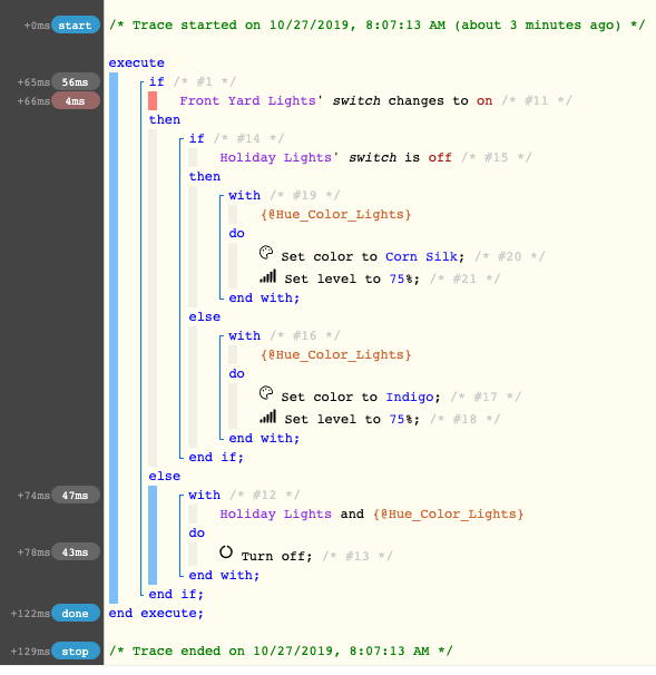

I have a virtual switch that I’ve created to control the front yard lights. I have a simple IF/THEN/ELSE setup. IF switch changes to ‘ON’ THEN turn on lights (this works), ELSE turn ‘OFF’ lights. The else command is executing.
Lights to turn off.
Lights not turning off.

In your ELSE…Are your Holiday Lights and @Hue_Color_Lights different types of devices? One a switch and the other a device? Try separating them into separate Off commands.
Yes. Holiday Lights is a “Simulated Switch” and @Hue_Color_Lights are bulbs. I’ll split them out and see if that works.
Didn’t understand your logic in the piston…
Front yard device CHANGES TO ON - i get this part…
But how do you intend to turn the lights OFF???
if it’s by changing Front yard switch to OFF, then use that as an IF block instead of using ELSE
